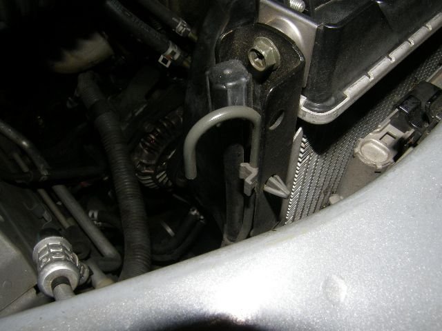

I popped the 2 lines off vacuum pump and off diff and I found moisture in intake line that comes from beside the rad and a little in pump . I gently blew them out until no sign of moisture and then added some airline antifreeze and blew out again . It’s been outside for about 3 or 4 hours and still working . Is this a common problem and should there be anything on the end of that candy cane looking intake line beside rad ? I just recently purchased this unit and have tracks on it , so don’t want anymore issues with it . Thks DB

I have never heard of this problem before.
My 2001 Tracker has the same candy cane intake pipe as yours.
Some versions of the Grand Vitara have a HOSE ASSY, FREE AXLE (39) that attaches to the candy cane.
The Suzuki part number is 27980-65D00.
