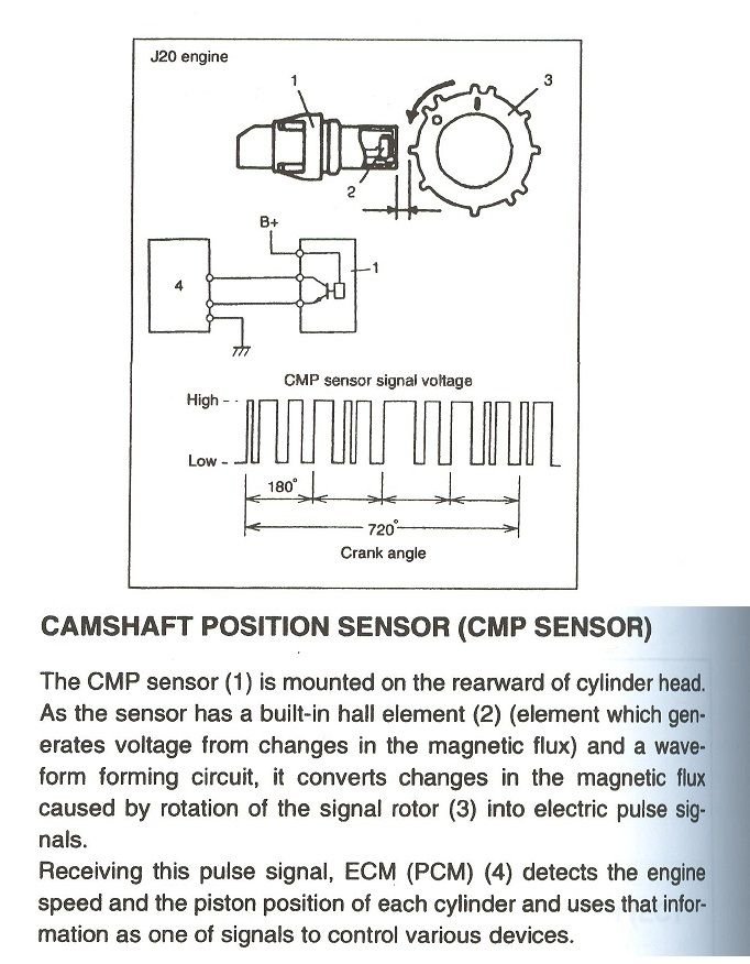

I think the CMP sensor is the place to start. That and the PCM are the only two things comon to all four spark plugs and it's unlikely water got into the PCM. The Haynes manual is correct in that the CMP sensor supply voltage is 12 DC. That can be checked with a voltmeter. You should be able the check the CMP sensor ground with a test light. But I don't know how you could check the CMP sensor output signal with a voltmeter. I have the V6 engine but the principle is still the same.
This is an actual oscillograph from my engine. You four banger does not produce reference pulses so ignore those. But notice the cam position pulses switch between 5-volts and ground and that the width of each pulse tells the PCM which cylinder is in position for firing. You absolutely need an oscilloscope if you want to see if the CMP sensor output is correct. A voltmeter will not do that.
The 2.0 liter engine sensor uses a Hall effect CMP sensor.
The irregularly spaced projections on the reluctor wheel produce the unique pulse widths on the CMP signal to the PCM. You'll need to find out if you are producing CMP pulses or a flat 5 volts DC when the engine is cranking.

The Snap-on Solus is high quality diagnostic scanner, but it won't be much help if you're not throwing codes. Your friend will have a portable oscilloscope, probably a "Picoscope" if he is a professional mechanic. With it he will be able to back probe the connectors on your PCM to determine if you have a CMP signal. On a related note, I followed the Chevy service manual flow chart for a "Crank, no start" using the answers you provided. It said to replace the PCM. I hope that is not the case.

My friend got back from vacation and came over with scope and sure enough, there is no cam signal.
