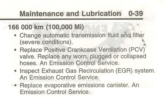

The O2 sensors produce very specific indicators to an OBD2 code reader or to a scope. Any decent mechanic could read it and tell you which ones are failing. The O2 sensor are a factory recommended change item at 100k miles. Of course you can do better. But if one is failing, it shouldn’t be long before the others quit too.

You’re right. It’s not in my service manual either.
But I know I read it from a GM source somewhere because it caught me by surprise.
Now I will have to go find the source. I don’t want to be a source of bad intel for maintenance.
Me either. I have googled this topic with mixed results but I'm leaning this way:
When Should You Replace Your O2 Sensor?
Oxygen sensors are not among the maintenance items that need to be replaced regularly, such as oil and air filters, so they typically are replaced only when they fail.
https://www.cars.com/articles/when-s...1420663031800/
