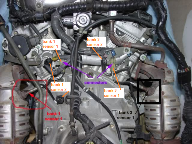

Your V6 engine has four O2 sensors: two on the driver's side (bank 1 upstream and downstream) and two on the passenger side (bank 2 upstream and downstream)
See Tracker 101: intro to the catalytic converter - Chevrolet Forum - Chevy Enthusiasts Forums
You could buy four cheap sensors at RockAuto for around $200. The sensors themselves are not hard to remove (no lift is required). But on the V6 the connectors are almost impossible to get to. They are behind the engine and there is little to no room to reach back there.
Most people have to remove the rear intake collector to get access to the O2 plugs.

This is not good. P0420 and P430 indicate both of your PUP converters are bad. Catalytic converters don't wear out. Some engine problem (usually a misfiring cylinder) causes them to go bad. Replacing them without fixing the engine problem will just burn out the new converters. Repacing the O2 sensors now is premature.
