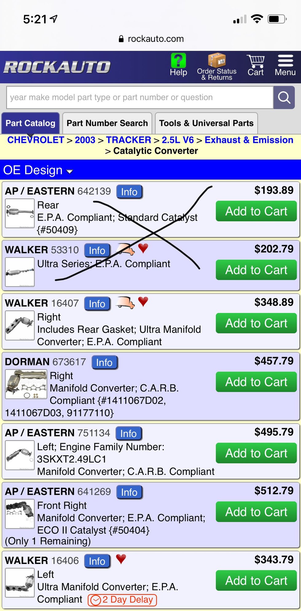

My vehicle has over 210,000 original miles. I bought it brand new back in July 2003. Now that I know what has to be replaced, how do I know which converter to buy if there are few options? It looks like my converters are EPA compliant. Please and thank you.
I have attached the options below, any and all recommendations are welcomed.

You will notice that converters come in two flavors: EPA (49-state) compliant and CARB (California Air Resource Board) compliant. CARB converters are built to a higher standard and therefore more expensive. You can pass inspection with cheaper EPA compliant converters in NY. Also be aware that the PUP converters are only warm-up converters. The main catalytic converter is under the floorboard. It's condition is not monitored by the PCM. I do not know if NY tests the condition of that converter during an inspection. Usually if the PCM is not failing the I&M tests the car passses the emissions part of the inspection.

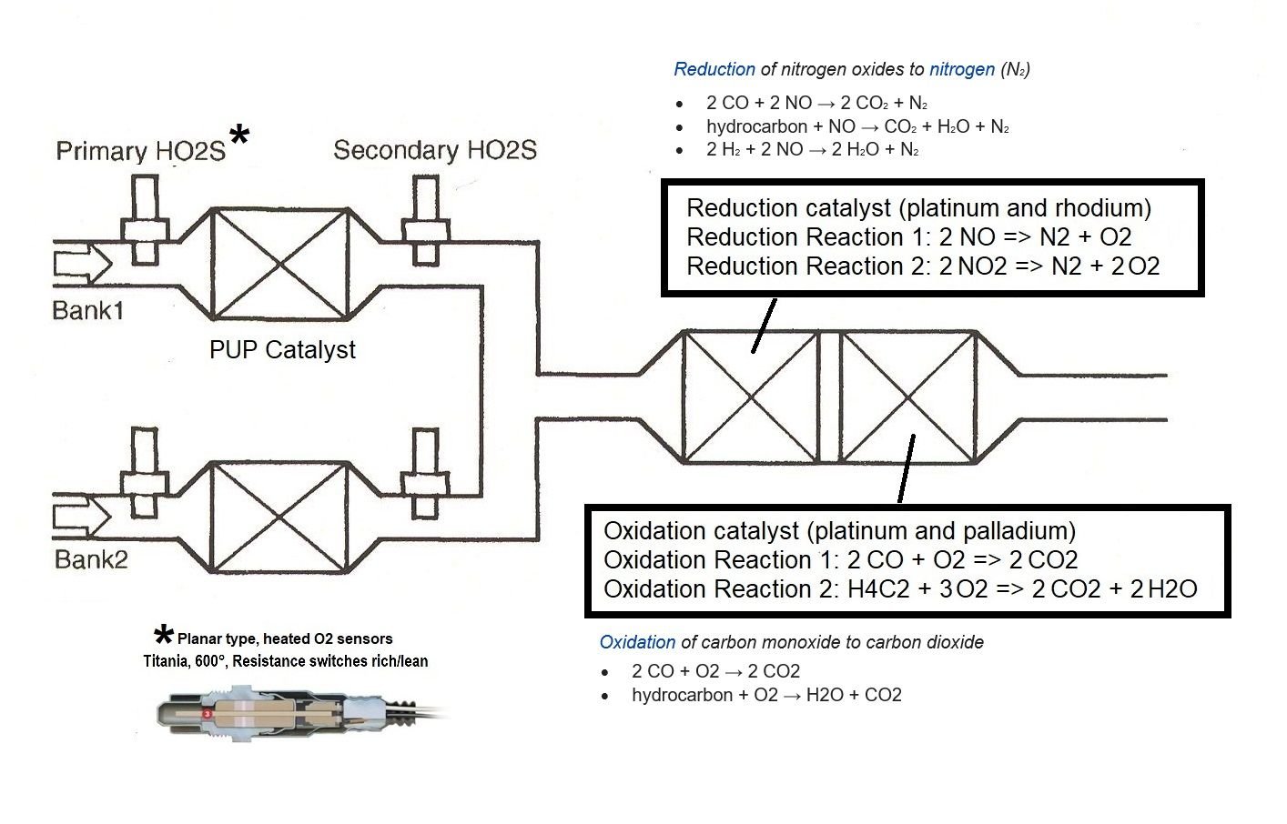

Chevy calls the left and right manifold converters "PUP" converters. I don't know why. The EPA compliant converters will clear the P0420 and P0430 codes. All four O2 sensors are functionally identical. The reason for the different part numbers is that the downstream sensors have longer wires.

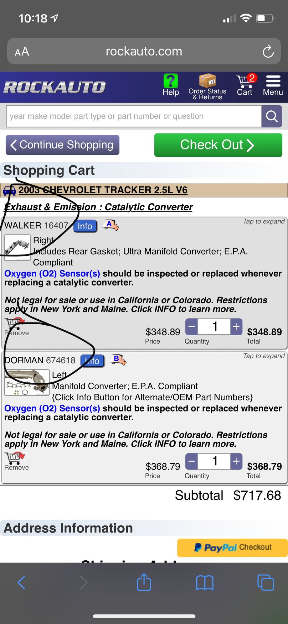

Can I install two different brands on the catalytic converters? One is a Walker, and the other is a Dorman. Not sure why the brands don’t have both sides. 🧐

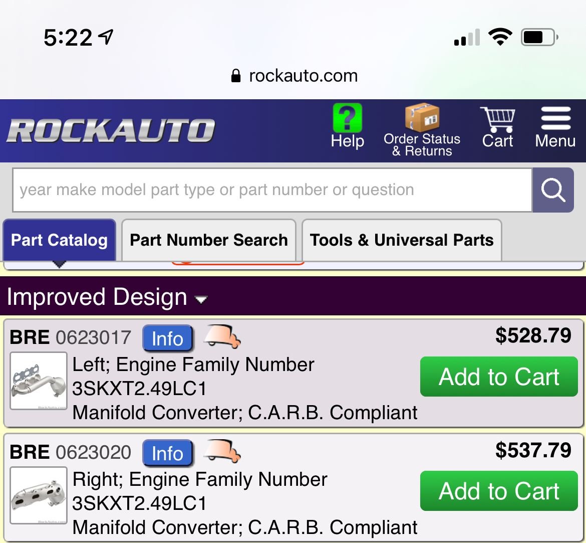

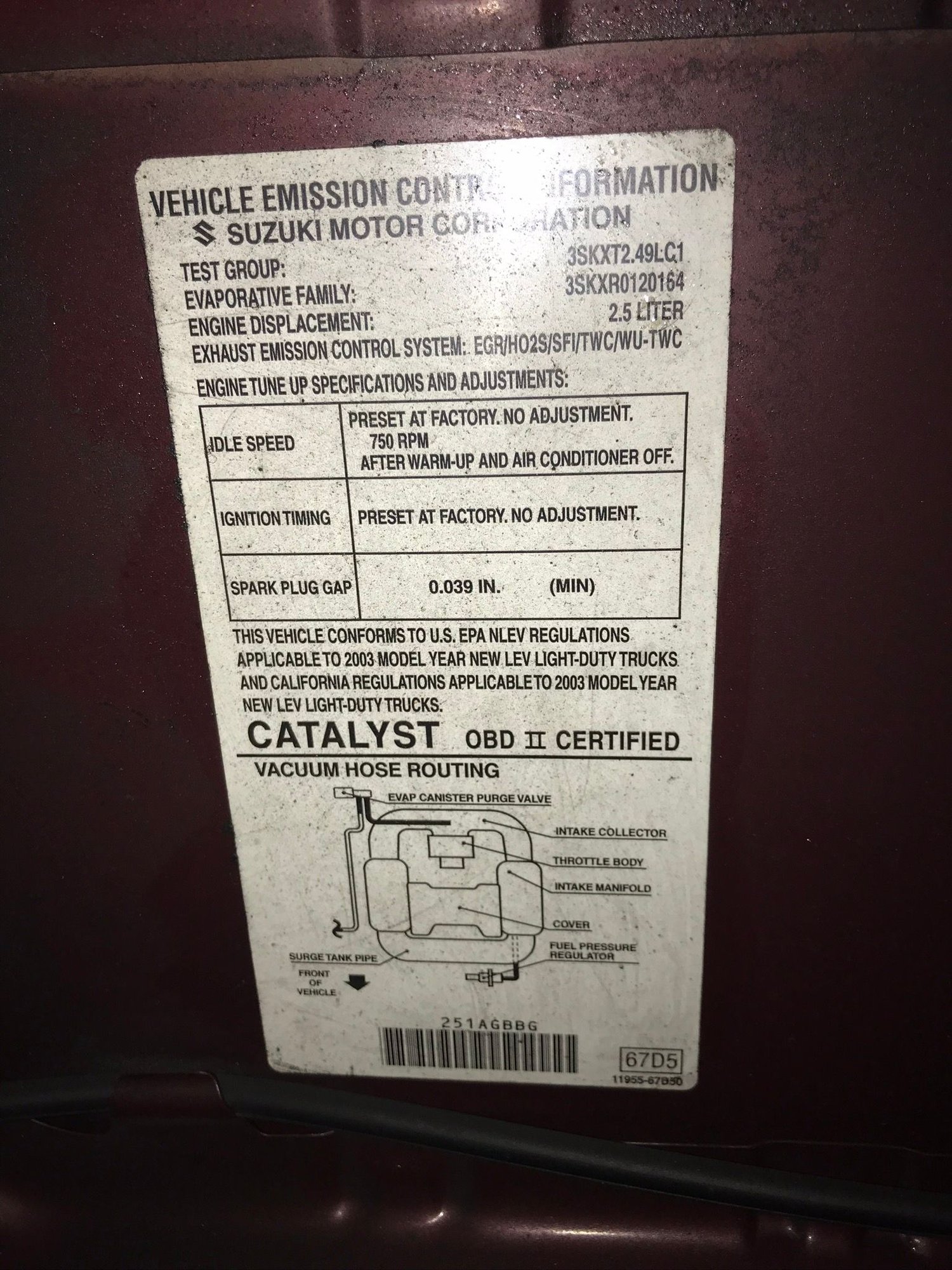

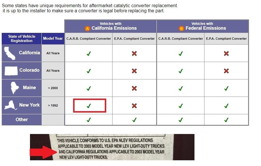

According to RockAuto, NY requires a CARB compliant converter if you have a California LEV certified car which according to your under-hood sticker, you do. It looks like you may need the CARB compliant converter to pass inspection. Check with the inspection station to make sure.
