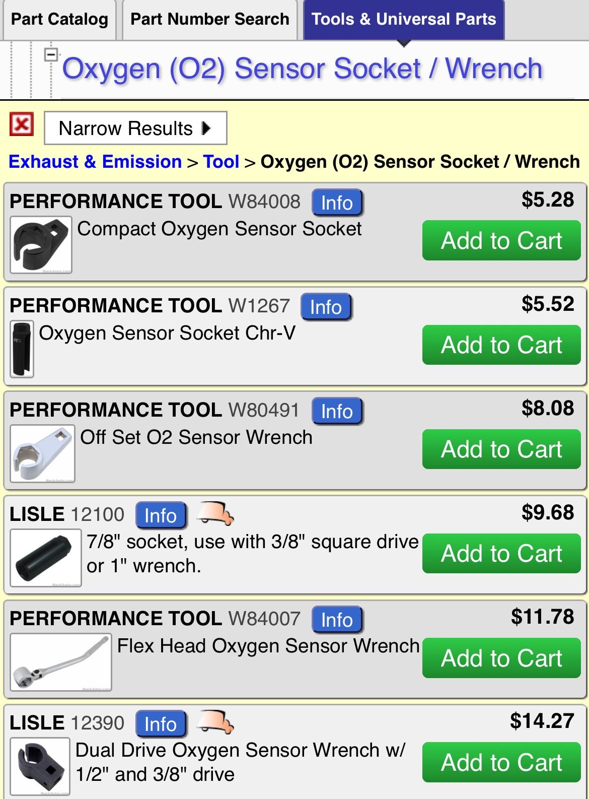

Hi everyone, I am attempting to replace four O2 sensors (upstream/downstream). Is it best to use an 18” breaker bar or 30” breaker bar, please? There are different tools to use, (3/8” or 1/2”).
I’m not sure which one to use so I am purchasing a dual one. If anyone can assist or suggest anything, it is greatly appreciated.
If I do need a tool or do not need a tool, please let me know.
Please and thank you 😊

i went to autozone and "rented" tool set OEM 27110. the reason i rented it was because some dont come with boxes if you buy them off the shelf. it uses a 3/8 breaker bar or ratchet. breaker bars might be too big to fit under the vehicle anyway. make sure to really soak it in pb blaster ot something or if youre using heat keep it off the o2 sensor and try to heat the bung only. ive had mixed results with o2 sensors sometimes they come out sometimes they dont. i wouldnt use a thin wall socket either as you dont want it flexing and rounding the o2 nut. so of that list you supplied i would go with a compact style as they tend to be thicker and are less prone to flexing imo.

Avoid the breaker bar entirely. First, I don’t think you will have room enough to fit it in there. Second, if you don’t get the B-nut socket square on the O2 sensor, you could round off the hex nut with the torque of the breaker bar. Don’t do it.
Use some PB Blaster or Aerokroil to loosen the O2 sensor threads. The O2 is torqued to 18 ft lbs, I believe. Not much.
Hell, even water displacement formula 40 (WD-40) should do the trick.
DON’T STRIP THE HEX ON THE O2 SENSOR. Whole new meaning to the word “hosed.”
