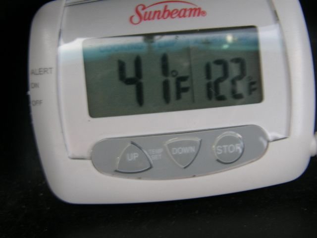

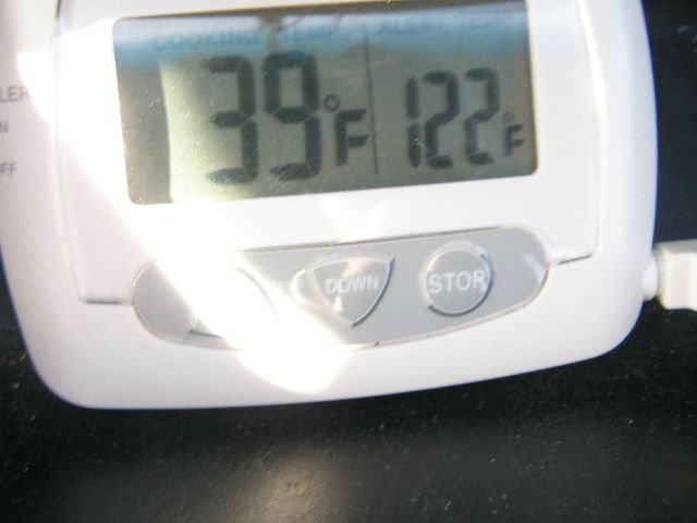

Nate-
I still can't see your posts here but I did check the A/C temp at the center vent on my Tracker this morning. The outside temperature was 82°F.
The vent temp was 41°F in less than one mile of driving.
I did see it flash 39° for a second. Keep in mind the temps will be lower when the car is moving and outside air is forced over the condenser coil.
