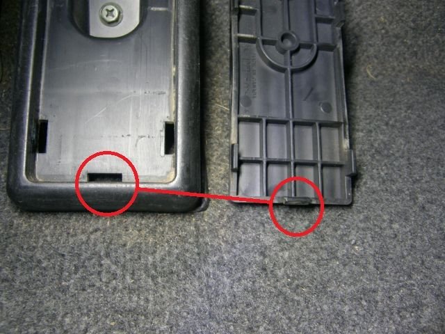

Nate, I have had the foot rest off before. Here are the instructions:

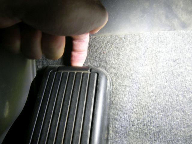

>> I don't see how the cover comes off,
The cover has a clip/slot arrangement at the bottom.
Pull with one finger at the top to pop it loose. Then wiggle it off.
