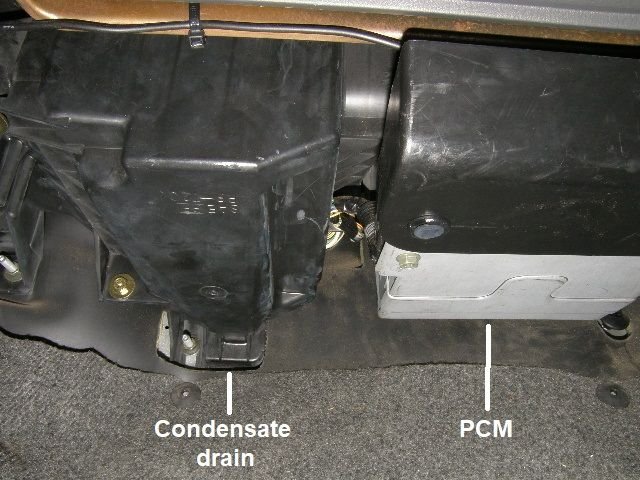

This is the illustrated parts breakdown (IPB) for my Tracker's A/C evaporator coil. Note callout 17 and the nipple it goes over. Callout 2 is the condensate pan the water drains into.
You can see the bottom of the condensate pan under the glove box.
Zoom in where the condensate pan (callout 2) touches the firewall. That foam seal is callout 17.

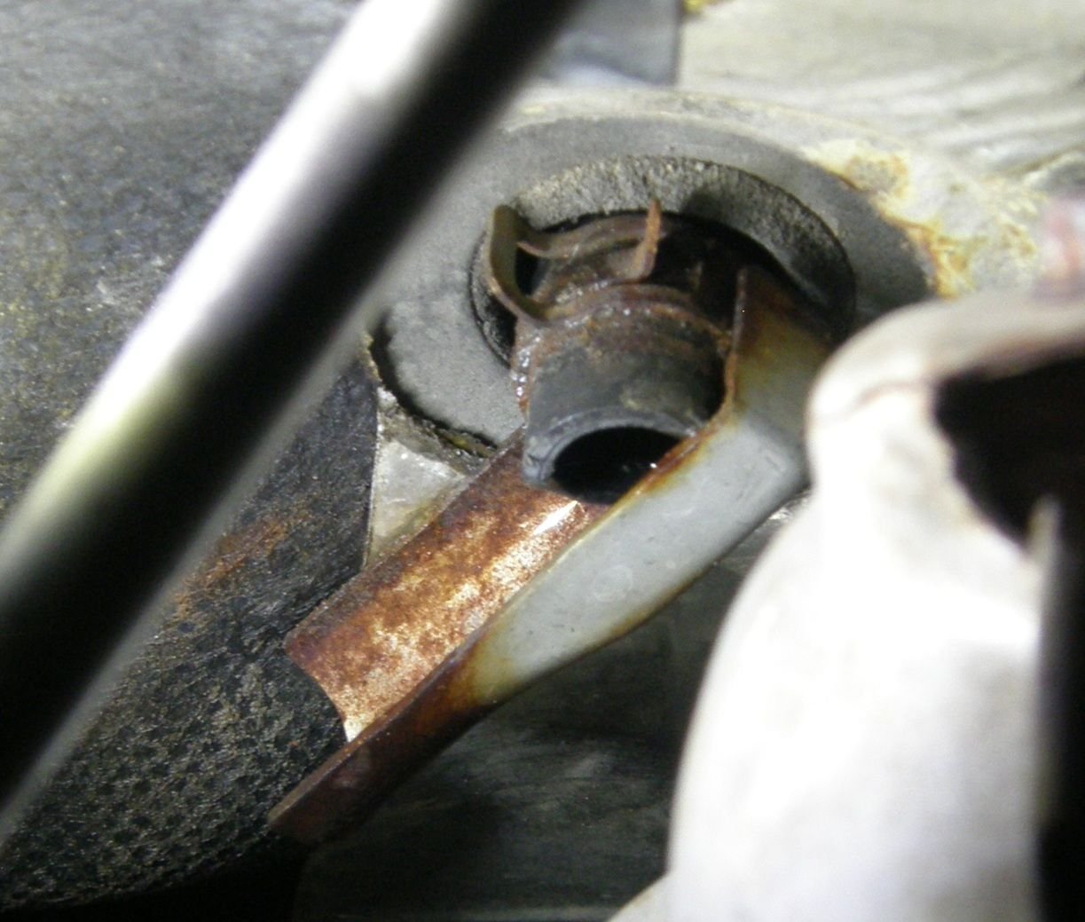

The nipple on the condensate pan protrudes through the firewall to the engine bay. If short rubber hose (pictured above) is not installed on the nipple, water could drip inside the car instead of draining to the engine bay. Is that hose present?

Thats perfect the detail i was looking for! I see that it's a foam seal so not a gasket issue. however, my drain nipple is hard plastic through the firewall, so I'm confused! well, it's not a luxury vehicle by any means! I guess I should be grateful that the AC works great and never has given me problems. There are bigger problems else ware I could be dealing with! THANKFULY NOT ON THE TRACKER!!! i think there may be a issue with my outlook account causing problems you mentioned.
