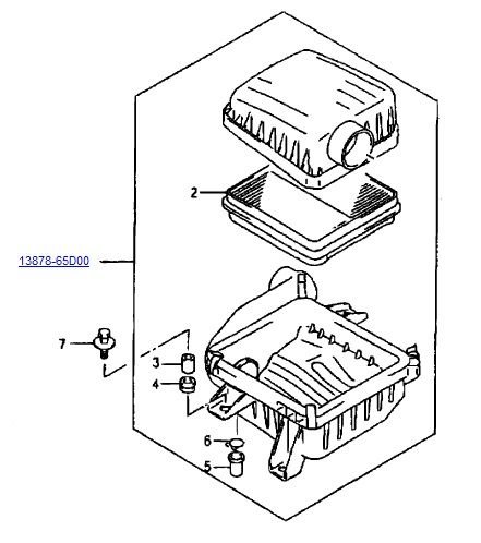

The clips are not called out individually. You'd have to get the whole air box assembly.
