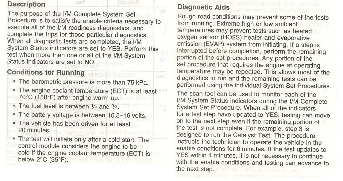

Is this what you are asking for?
Is that for evap or everything?
"Cold" is under 35F?? Well that's never going to happen here in AZ...
Would be nice to see more context for the "I/M System Status"es

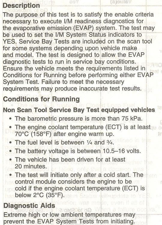

These are the EVAP I/M requirements. I never noticed that 35° requirement.
Maybe that's why my I/M tests don't run.
But my EVAP I/M won't run today because I just filled the gas tank. Which EVAP code did you have stored?

You didn't say what year model your Tracker is. These are the four possible EVAP codes on my 2001.
P0440 EVAP leak detected (small)
P0450 EVAP Pressure Sensor Malfunction
P0451 EVAP Pressure Sensor Range
P0455 EVAP leak detected (large)
How are you going to get around the 35° cold start requirement?
I was pretty sure it had something to do with the VSV and I'm hoping it was a fluke....but then again someone had deliberately broken the CEL so it must have been on for a while.
It's a 2003
Just going to hope it doesn't actually require a temp that low. If it does, I suppose I can pull the coolant temp sensor wires and replace it with a potentiometer temporarily.

" I suppose I can pull the coolant temp sensor wires and replace it with a potentiometer temporarily."
Can you show them documentation that the I/M test will not run above 35°? Surely you're not the first person to have this problem.
