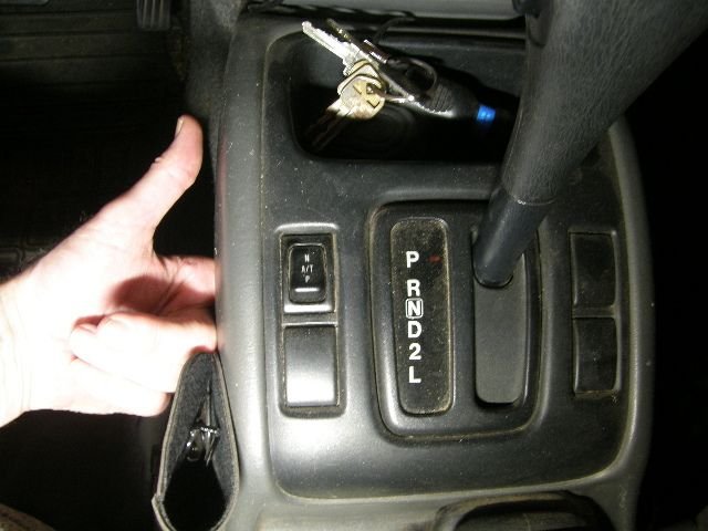

These are the instructions from Chevy. Do not skip step 2. If the key is in the OFF position the steel cable that runs from the ignition switch to the center console will not allow the return plate to move.
The return plate is located under the red square.
You need to reach in this far.
The return plate doesn't move very much. Shift into "R" while holding the return plate towards the rear of the car.

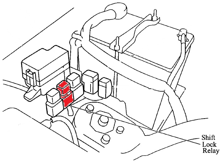

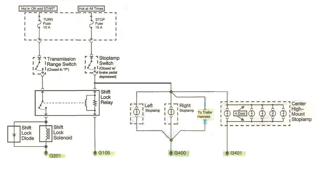

If the starter motor cranks and the brake lights and turn signals work, possible points of failure are the shift lock relay (located under the hood) and the shift lock solenoid (located under the console).

>> Once I get back out to where I need to be I will take a more in-depth look and see which part needs to be replaced!
This is the location of the shift lock relay on my 2001 Tracker. You should be able to hear/feel it click every time the brake pedal is depressed.
