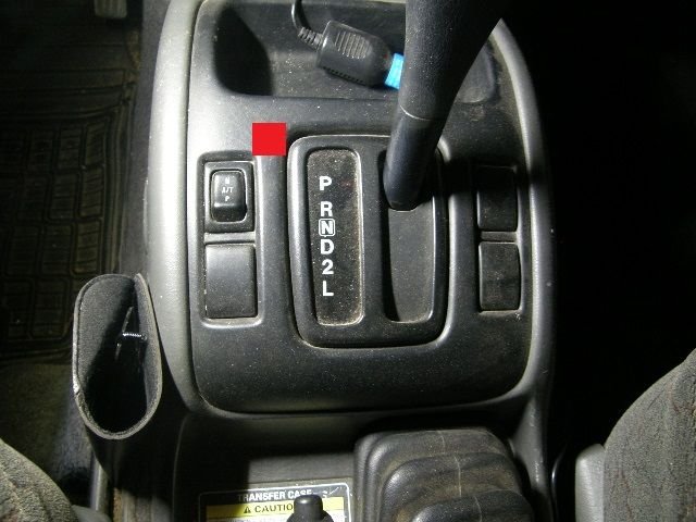

>> My gearshift is stuck and won’t go in reverse
Does that mean it's stuck in park? If so, you may have a faulty shift-lock circuit.
Follow the instructions below to manually release the shift-lock.
The "return plate" is in the vicinity of the red square.

>> Any idea how to fix, check what first?
First verify it's a shift-lock problem. Manually release the return plate and ensure the shifter comes out of park. If the shifter goes in every other gear position after it's unlocked you have verified it's a shift-lock problem.
