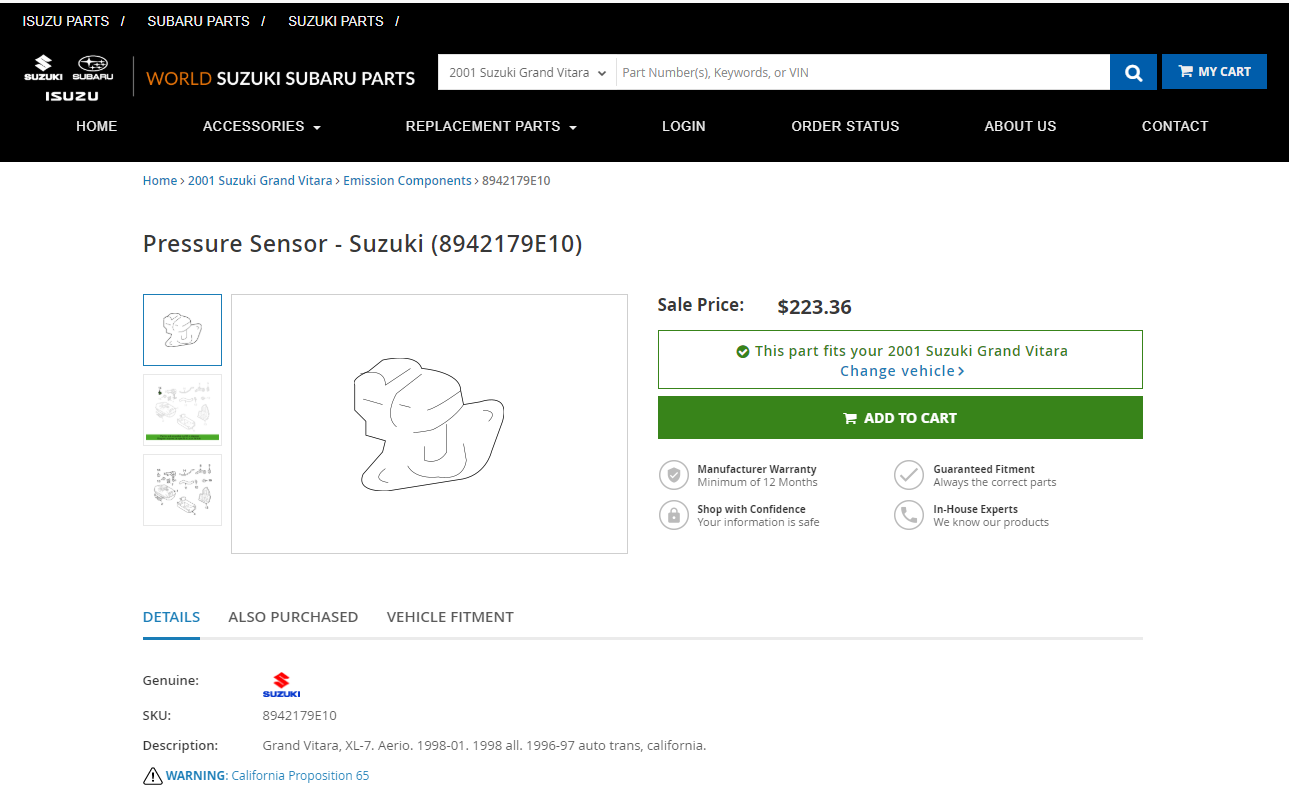

https://suzukisubaruparts.worldoempa...sor-8942179e10

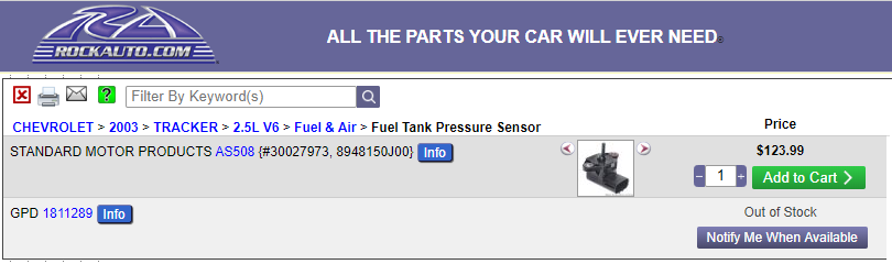

https://www.rockauto.com/en/catalog/...re+sensor,6385

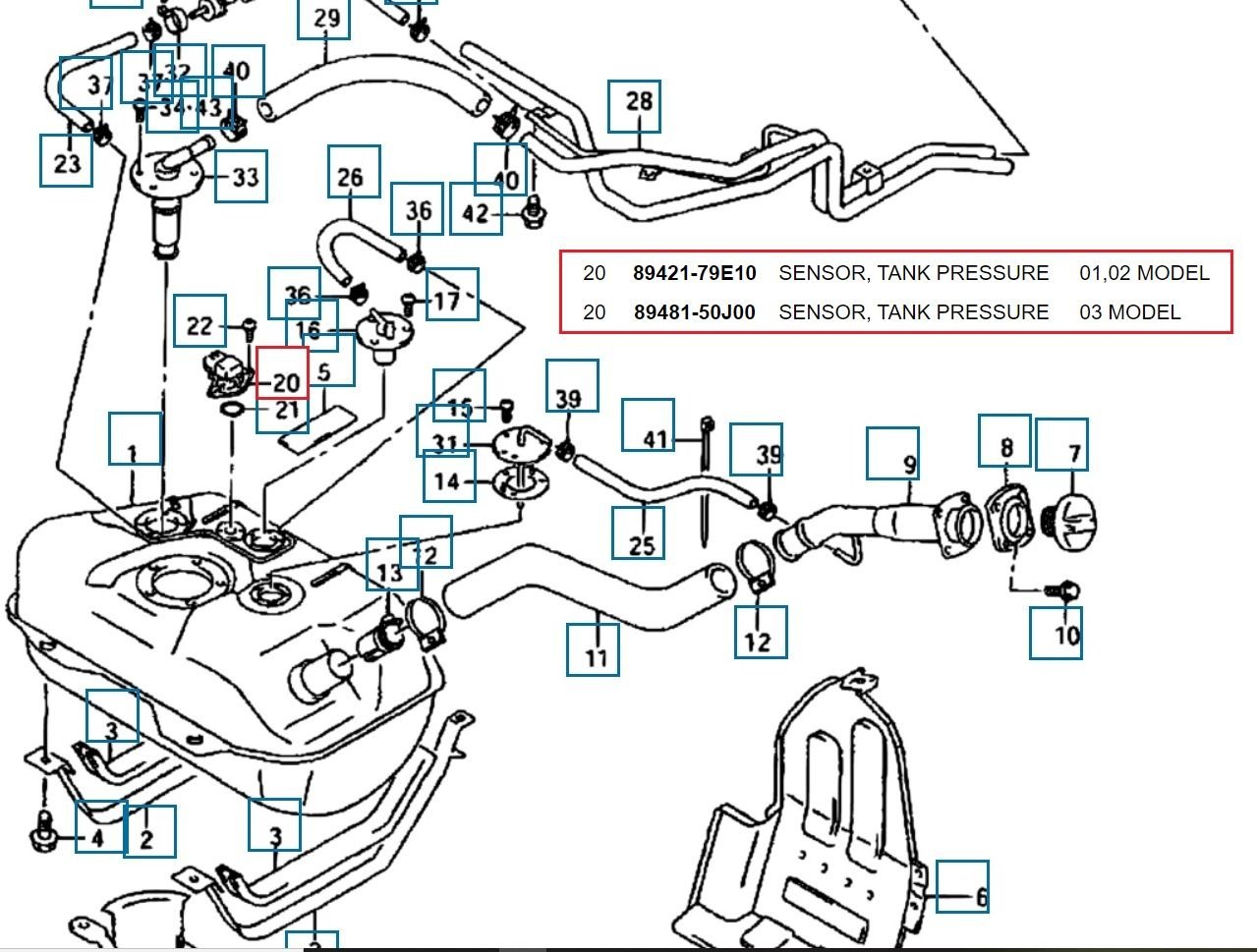

https://catalogs.ssg.asia/suzuki/?la...ZD09NTkwMjA%3D
Just to be clear, the part number for the 2002 and earlier Trackers is different from the 2003 and 2004 models. The newer pressure sensor is easier to source. The older one not so much.

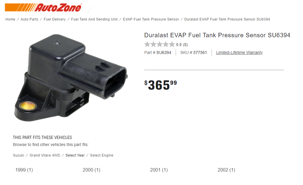

AutoZone claims to have one to fit the older Grand Vitaras

I found that 1999 thru 2002 Trackers use a 3-pin sensor and 2003 and 2004 use a 4-pin sensor.
RockAuto is also showing a 4-pin sensor for 2003 and 2004. I have been unable to locate a 2003 Tracker schematic to
see if they actually use all 4 pins, but it appears that any of the fuel tank pressure sensors part numbers with 3-pins will
fit a 2001 Tracker.

I would be absolutely sure the old unit failed a bench test before I paid the ridiculous amount of money they are asking for a new sensor.
