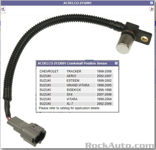

The Tracker's (H25A) V6 is a Suzuki engine co-developed with Mazda and Toyota. GM's input to the car's
design was more cosmetic than anything. The CKP sensor for the 2.0L (J20) and the 2.5L (H25A) use a
single 2-wire magnetic induction crank sensor (below).

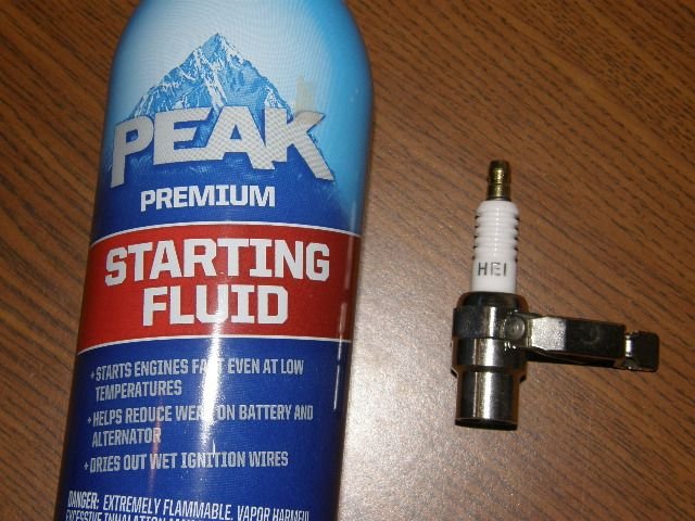

Step 4 in the flow chart ask you to check for spark. You can do that with one of these inexpensive
spark testers. If indeed there is no spark then follow the flow chart. If there is spark, spray some
starter fluid into the throttle body while cranking. If it starts you have a fuel problem.
