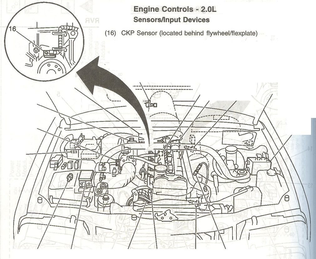

I found this J20 component locator in the Chevy service manual.
From this picture it looks like the CKP connector is inches above the starter motor.

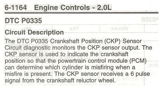

Further research indicates the CKP plug is below the intake manifold as shown in the earlier photo.
Also, the CKP resistance should be around 570Ω. If the scanner is not showing a P0335 DTC,
the CKP is probably good.
The more I learn the more it seems the engine does not require a CKP signal to run.
I was stunned to read the transmission has to be removed to change the CKP sensor in a J20 engine. Ouch!
