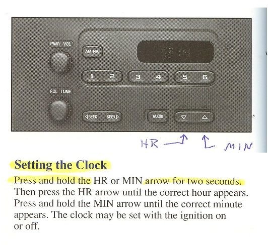

Hi, I have a weird situation. When I turn off my Tracker the Radio doesn't turn off. The music and what not turns off but the clock stays on and the minute just changes rapidly. Even when the Tracker is running the clock does this. The hour doesn't change but the minutes just cycle through very fast and it goes on and on and on. I wouldnt really care because I only use it in the woods anyways but it kills my battery because it won't turn off so I have to disconnect my battery so it doesn't die. Anyone experience someone weird like this?

The UP button on the audio control is stuck.

Even if that's the case. I dont think that explains how the clock continues to run while the vehicle is turned off and the keys are out of the ignition?

The clock set function works even with no key in the ignition. Press and hold the UP button for two seconds and the clock will come and stay on as long as the button is held down. The minutes digits will count up continuously. It seems likely the switch behind the button is stuck in the ON position. I have no idea how to fix it. Tapping on the button may knock it loose. If you don't need the radio you could unplug it. The only sure fix is to replace it.
