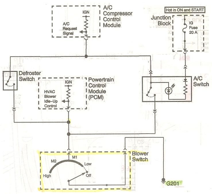

The link between the rough idle and the blower switch is the "Blower Idle-Up" signal going to PCM. Either the G201 ground is not getting to the PCM, the PCM is not processing it or the IAC is not responding to the PCM.

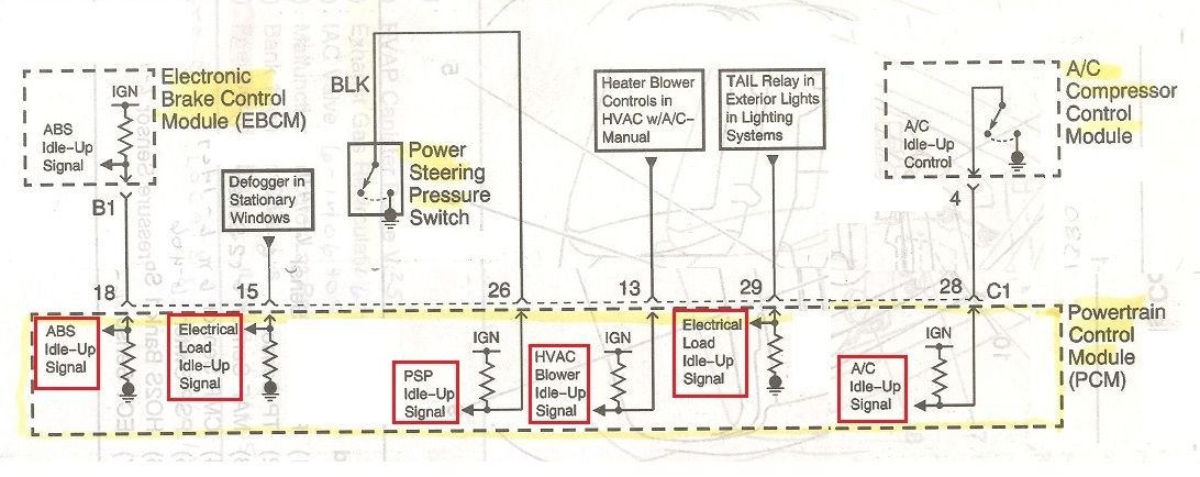

The HVAC blower is only one of six idle-up inputs to the PCM. All of then are handled the same way: the PCM sends a signal to the Idle Air Control (IAC) motor to allow more air into the throttle body (increasing idle speed). If your IAC is not responding, you have six different conditions that can cause rough idle.
