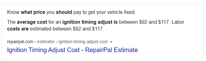

It will cost you between 90 and 100 US dollars to reset the timing.

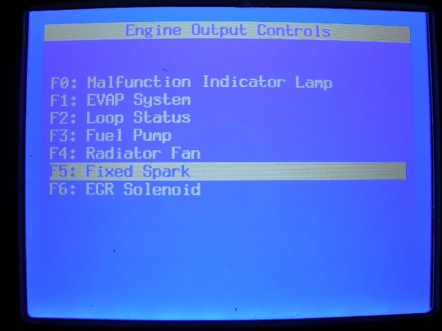

You'll need a Tracker specific scanner.
A generic scanner will not have this function.

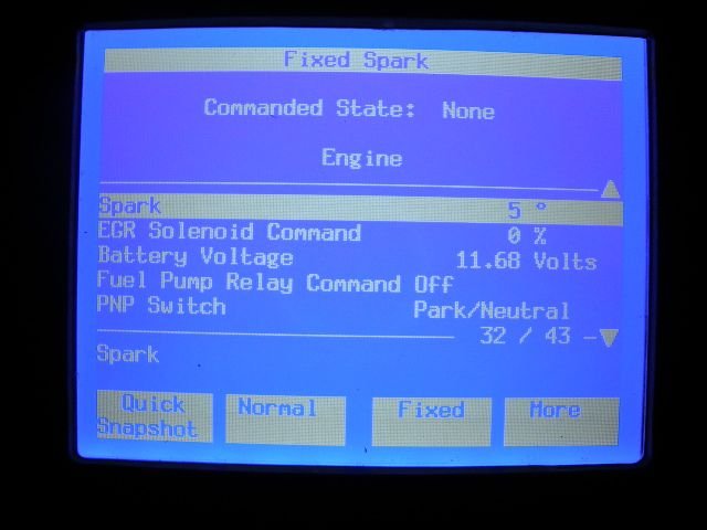

With the spark advance locked at 5°, connect a timing light.

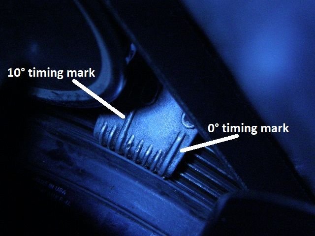

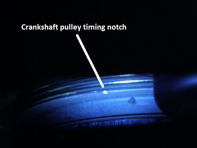

Mark the crankshaft pulley notch with paint or chalk.
Rotate the body of the CMP sensor until the pulley notch is half-way between the two major timing marks.
