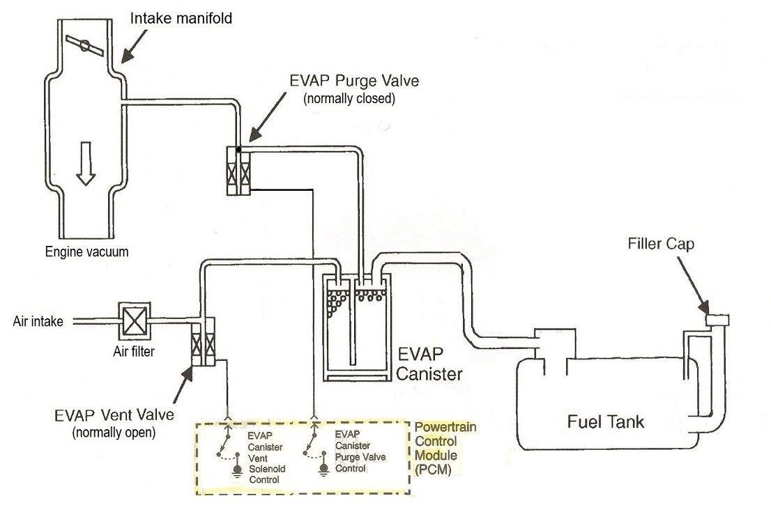

Why does my 2001Tracker take so long to refuel? When I refuel it keeps burping and shuts off.
For fuel to go in air must go out. Air is supposed to exit the through the normally open vent valve but if the EVAP canister is soaked with liquid fuel the air can't pass through.
