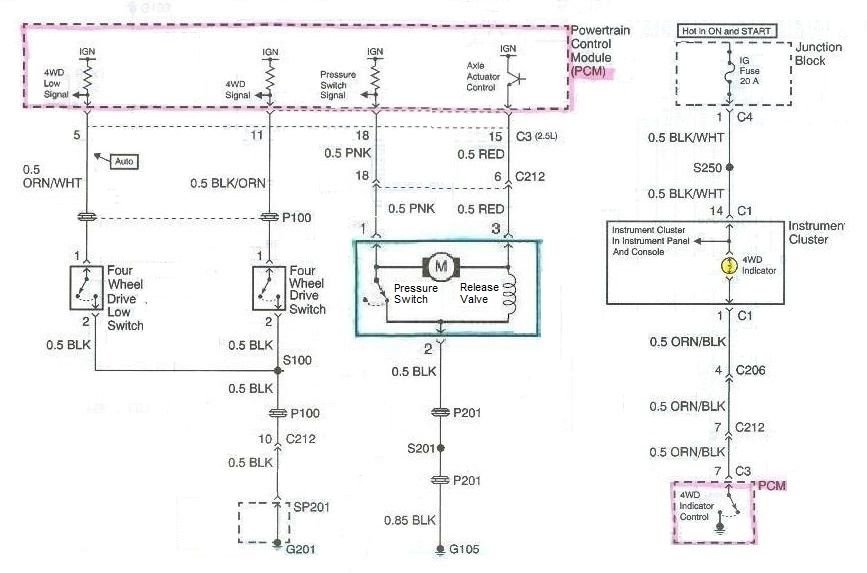

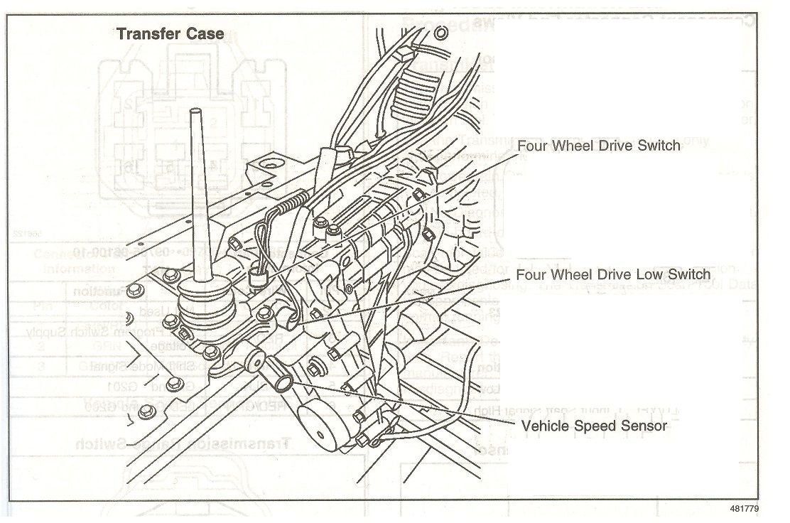

Update to my front end issue- Got the axle parts to my mechanic, but after install the Tracker still wanted to go into 4WD while driving. My mechanic said it could be one of the switches mounted on the transfer case. Back to suzukiautomotiveparts.com and Steve came through with not only a schematic, but got the parts to me within 3 weeks. I think they had to be shipped from Japan. Got the switches installed, and my mechanic said after driving for about 20 miles the situation in resolved. Thanks for your help in sourcing the parts and thanks to Steve at suzukiautomotiveparts.com!

>> Steve came through with ... a schematic
Did the schematic look something like this?
My 2001 automatic has two 4WD switches mounted on the transfer case.

I should have said an exploded parts diagram, not a schematic. It was helpful for me in determining which switch was the culprit. My mechanic replaced both, but told me the one on top, 4WD High, was corroded. It must have been shorting out, causing it to try to cycle into 4WD without moving the 4WD stick.
