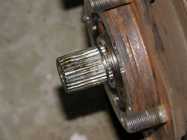

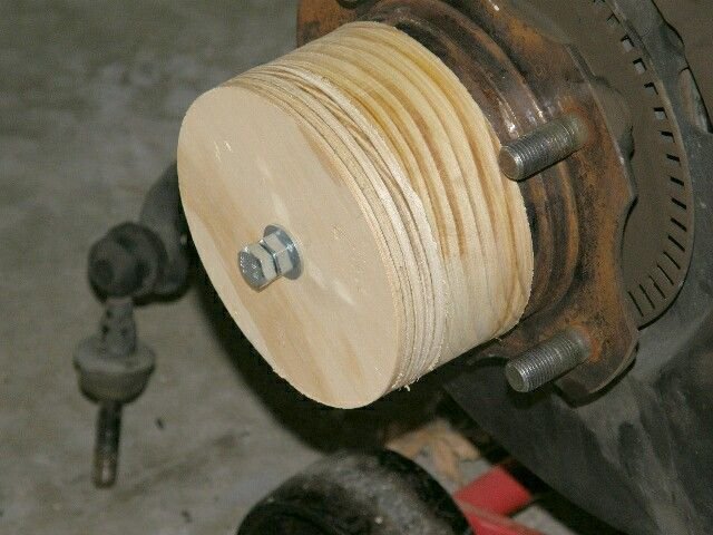

> Was it correct to add [a bolt] through the hole under the axle cap?
The threaded hole in the end of the axle should not have bolt in it.
I'm not very strrong so I made a tool to help pull the axle through the spindle to get the snap ring seated.
My tool screws into the hole in the end of the axle.
The axle has to come forward enough to expose the snap ring groove.
You mentioned the snap ring on your axle was missing. I am currently running my front passenger side axle without a snap ring because I have an ongoing problem I have not been able to solve. For some unkown reason my axle is destroying snap rings. I've taken it to several 4WD shops but nobody had a good answer. One place said it was due to the suspension going up and down. I'd like to know if your car starts doing anything like that.
