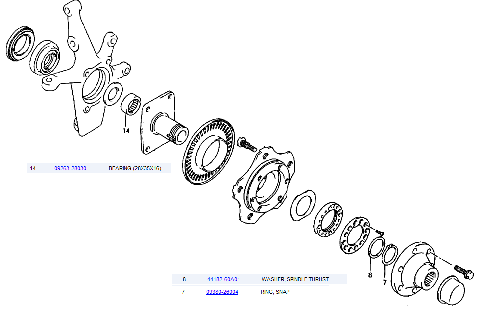

I found the washer and snap ring at suzukiautomotiveparts.com (see exploded view above) but the bearing (#09263-28030) comes up not applicable for a 2001 Vitara (Tracker) 4wd . Does anyone know how I can get the correct bearing?
Old Nov 3, 2023 | 8:02 PM
L84sky's Avatar
Joined: Oct 2018
Likes: 157
I have replaced that bearing.
The part number you have is correct for a 2001 Tracker with 4WD.

I had just acquired the vehicle and drove it several hundred miles. First I was getting a clunking from the front end that was diagnosed as bad sway bar ends. I replaced them and the clunking stopped. Then, a couple of times while going between 30-40mph, I would get a rapid vibration, like going over the hash marks cut in the double yellow lines in the road. It would disappear after slowing to a stop. I took it to a couple of mechanics in town with no luck, and finally the last mechanic found I was missing the thrust washer, snap ring and he said I probably needed that shaft bearing. I can only assume that someone before me had the axle apart, maybe to get at the bearing, and then reassembled it missing those parts. I never heard the typical bad bearing grinding noises, so I don't think the damage was anywhere near as dramatic as the bearing in you picture.
I have a question- One of the previous mechanics told me there was a bolt under the axle cap missing from the drivers side. They saw one on the passenger side, so they added one to the drivers side. I don't see one in the exploded diagram. Was it correct to add one through the hole under the axle cap? -Crikman
