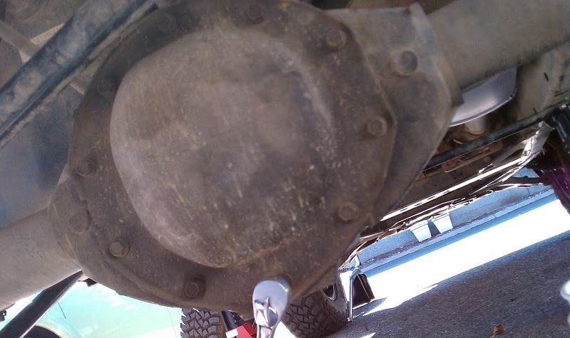

I'll get the mobil 1 syn. for the 97x. this rear ends case has a complete different bolt pattern compared to the cars 10 bolt is this a 7.5" 10 bolt? so the new paper gasket was also for the express. the original gasket seams reusable.
Iv'e reassembled the rear cover however there is one extra long bolt however I didn't take note of where it was located.
been looking for a emergency brake cable that if I remember correctly is attached to the diff. w/ this longer bolt but didn't see the cable.
wish I took a image before disassembly. been searching the net couldn't find much but this attached image aurther wrote it's a trailVoy notice there isn't a E cable attached to diff.
Thanks for advice TB
the panhard bar on my 97x is alot lower than this image

It's the wrong oil for that too.
His vehicle is probably jacked up by the frame so the axle is hanging down.

so there's no emergency brake cable that's supposed to be attached to the diff. w/ this longer bolt? thanks TB
Old Apr 5, 2019 | 12:35 PM
Usually @ 12 o'clock
Try googling trailblazer. Same platform.
