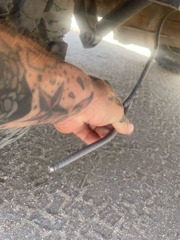

Would this be my linkage / shifter cable or something else related to the problem?

That there looks to me like a parking brake cable. Although that doesnt meant the parking brakes aren't locked on solid. I presently don't have my phone handy, so I cant get a picture of my own shift cable for ya right this second. I will try to get that posted this evening.
Also, I don't remember if I said anything about making sure the transfer case isnt in neutral if the vehicle is a 4WD. Especially in the rust belt the electric engagement motors have trouble moving, as the pins aren't well protected from salty roads. Potentially the driveline is fine?
Does the truck labor under throttle revs or does it sound like its freely revving? if it labors, I would think perhaps the parking brakes are locked up, but it should have enough jam to power past them, which I think you likely would have found.
Freely revving would seem to be more like broken stuff OR the aforementioned 4WD transfer case not fully in 2WD hi or 4WDhi/lo.
I don't remember perfectly if that year had a manual handle for the transfer case or if it was vaccuum actuated or electric. i know my 1998 and 1999 have the electric engagement, and both have a separate neutral on the case plus a neutral for the transmission to get into.
Rambly rambly, basically you might could be in 1 of 2 total neutrals, IF its 4WD.
