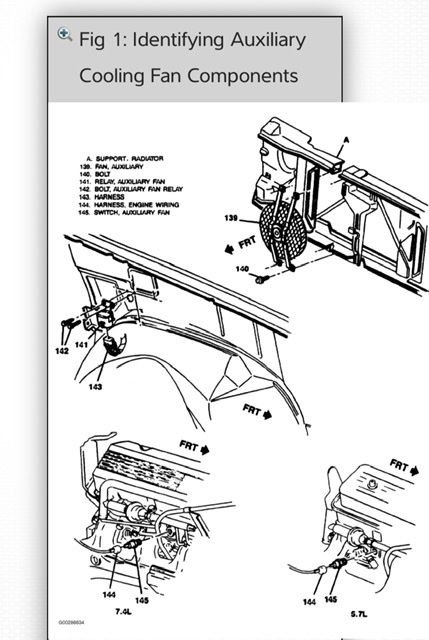

I have seen pictures of an auxiilary fan unit for cooling on the front of the condenser/radiator area. It works as a pusher fan.
Does anyone know if this unit is one that is compatible with my model of vehicle?

It looks like the stock fan, so it should be. If your truck wasn’t originally equipped with the fan, measure the distance between the upper and lower radiator supports as well as the distance between the radiator and nearest point on the engine. Compare those measurements to the fan to make sure it will fit.
If it’s having issues with running hot at idle, try washing the condenser and radiator fins using a garden hose from the engine side.
