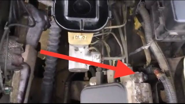

1) There’s a pintle on the combination valve that needs to remain depressed during bleeding. It meters fluid flow to the rear brakes and can allow air to be trapped inside the valve, regardless of how much time and fluid has been used.
Have a helper depress the brake pedal and look/feel for the pintle - it’s typically on the top or front of the valve, covered by a black cap. The one that extends when the pedal is pressed is the one that needs to be held down.
There’s a clip tool available for this (
Amazon Amazon
), but a penny and tape or zip ties will work if you can secure them properly.
Valve/pintle location
2) A method I’ve always used for adjusting drum brakes is to tighten up the adjuster until you can’t turn the wheel, then back off the adjuster one full turn. Then go for a short test drive (2 miles or less) and check to see if the drums are too hot - if so, back the adjuster off another 1/4 turn and repeat.

I forgot that some trucks were equipped with the ABS and combination valve as one assembly (may have been a design change too - I’m not sure). If that’s the case for your truck, the pintle should be the one marked by the arrow, but again, confirm that by checking for movement with the brake pedal.
The pintle needs to remain depressed throughout the whole bleeding process.
