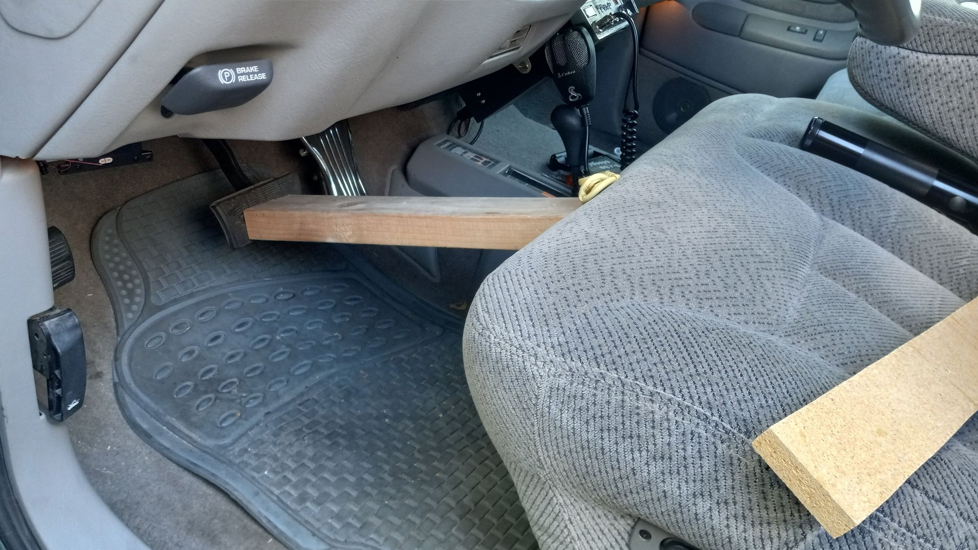

I proped the break pedal down with moderate presure between the seat.
Here is the aproximate angle of the truck.

So, I found out something very interesting today. But first, I must summarize the results of what @Gumby22 recommended me do. I parked the truck on an angle, nose up, with the front of the truck probably about 8" - 10" higher than the rear, hopefully the picture with the level conveys the idea, then I propped the brake pedal down with a 2x4 as pictured and left if for I believe 2 days. I got spooky results from the test, but thankfully, I think the truck may be healing itself. This morning, after taking the 2x4 off of the pedal and lowering it back onto the ground, the truck did not want to come out of park. It took a minute to get it into gear, but I had to push down the brake pedal VERY far to do so. And this did not seem to make the pedal any firmer, but I think I know why.
2x4 propping brake pedal with moderate force. (No offence to Gumby, but I would not [size=13px]recommend[/size] [size=13px]propping[/size] the pedal down, as it messed with my shifter, [size=13px]making[/size] it difficult to get the truck out of park, hopefully it comes around)
