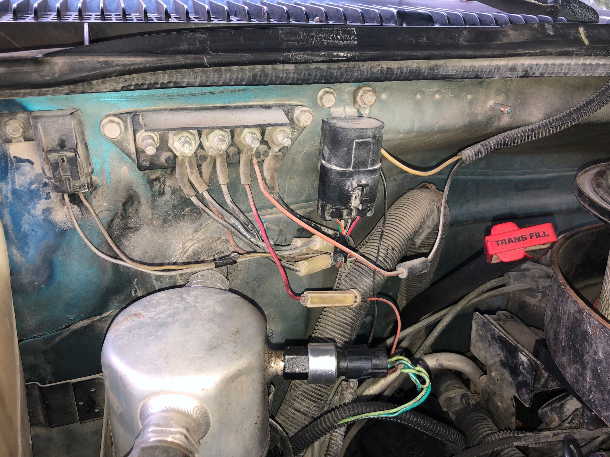

Please let me know if the TCC fuse is in the underhood group? I see several in line fuses? Could a bad brake switch be the problem with TCC not disengaging properly? Thanks
