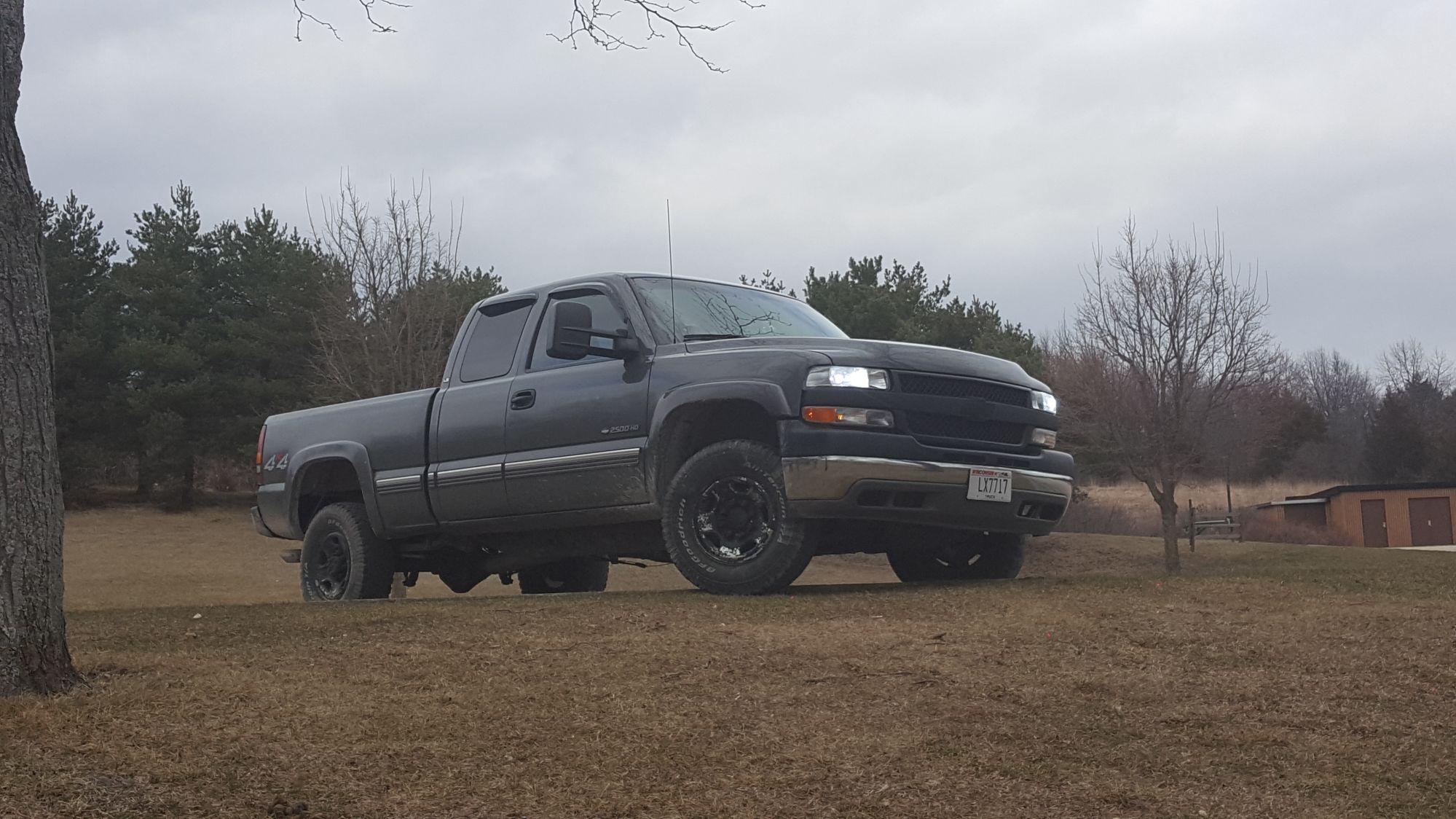

Tryin to figure out the generation of my engine so i can get a replacement head gasket. Rockauto has different opinions. Not sure what one to get. Can anyone help?

you should be able to tell from the rpo codes in the glovebox

RPO codes on the glove box door and check them in the PDF link below will give you all the information for the truck....
