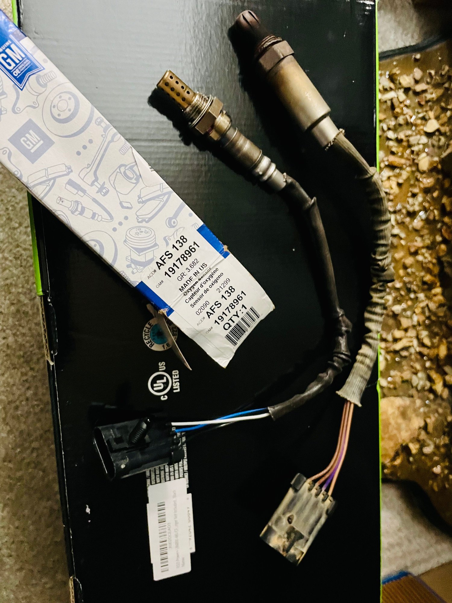

I removed a up stream 02 sensor for replacement with another GM sensor but the color code is different as well as all around looks. I have seen where this happens due to different vendors manufacturing making the product but can not recall GM ever doing it. I do not feel good going forward without knowing this is the proper sensor for 2001 Silverado with a 5.3.
Thanks for anyone’s input,
Blockaidrunner

I looked the O2 sensors up for your 2001 Silverado with the 5.3L engine and the upstream sensor is listed as either GM Part Number 19178961 or ACDelco AFS138. The downstream sensor is listed as either GM Part Number 19355306 or ACDelco AFS106.
GM over the last year or two has changed the labeling and box colors for their parts as part of their "master plan" to group their replacement parts into 3 tiers. Their best tier, which are OEM parts are in the Blue colored boxes. These are supposed to be the same parts that would be/used to be/are to be used on the factory production lines, and are therefore their premium line of auto parts.
The parts that come in the Gold colored boxes are their Professional line of auto parts which are described as being very good auto parts that are fully functional and fit for purpose and are aimed to be competitive with quality aftermarket parts from other brands.
Parts that come in Silver colored boxes are their "Value" line of auto parts (used to be their Advantage line) and are aimed at the thrifty consumer looking for a good value auto part (now in my words - 1/4 to 1/2 a step above ebay and Amazon white boxed chinesium auto parts that are priced so low one really has to wonder if they are real or fake auto parts).
Not sure who is making this round of Oxygen sensors, but they do come with a 2 year 24000 mile warranty and are supposed to meet GM's OE specifications, so I would not worry about using them. These would be the same parts that a dealership's service department would install if you had them replace your Oxygen sensors.
Good Luck!
