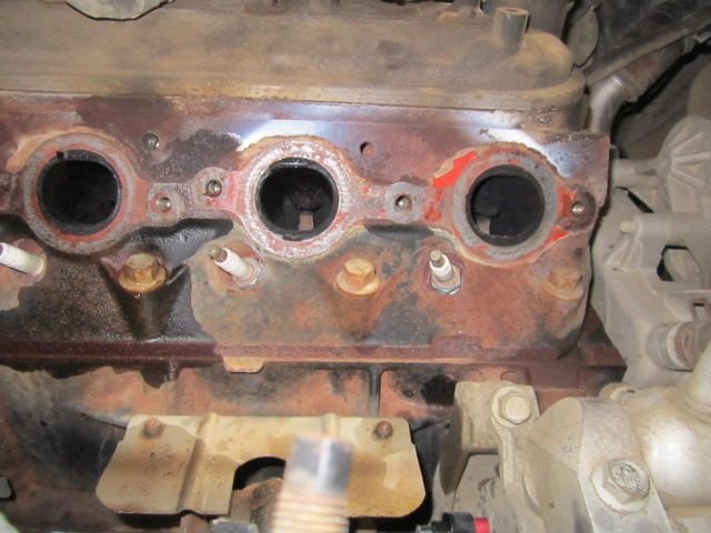

front broken bolt lh side
rear broken bolt lh side firewall
i've worked on worse...
my son started working on removing the manifold while i was at work yesterday. he found another broken bolt at the front this time.
plenty of heat and patience , and the remining bolts came out unbroken...
the 3 on the down pipe? two of them, even with the induction tool, still pulled the threads completely off the studs...meh, a new stud kit is on hand. attached the manifold to a saw-horse and heated the flange cherry red, drizzled paraffin wax over exposed threads, and made those studs scream for mercy while using 2 pairs of vise-grips to remove the damaged studs-
then my son cleaned the holes with the proper tap and drilling fluid- the new studs screw in and out with ease! i have extreme temp anti-seize to go on the threads at final assembly. right now its just prep work / cleaning the flanges on the manifold-
Those two broken bolts? i do have left hand drill bits, but those may just snap due to the heat cycles that those threads have been put thru. and the broken bolt by the firewall, a drill cant get in there.
Or weld. i do have my mig and a bolt bin full of nuts and washers- not my first rodeo when it comes to welding out broken bolts...just lots of extra items that could burn/ get damaged from welding...

got the two broken bolts out. drivers side all thread chased, will clean up the area and change the oil cooler pipes/ hoses while there is extra room in there-
someone spent time using silicone for a gasket, even between the steel layers of the actual oem gasket- at least no bolts broke.
used the induction heater to remove the studs from the manifold.
all new gaskets and hardware will be used.

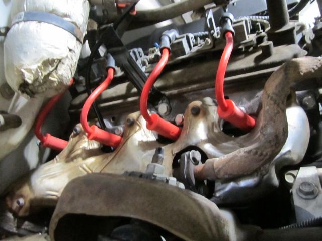

all cooler lines, other than the power steering, are in place. new o-rings in all the fittings. new motor mounts installed, then the exhaust manifolds were installed, along with new dip-stick tube and hardware with high temp anti-seize for any of the exhaust / cyl head fasteners.
new spark plugs and 10 mm spark plug wires installed. those spark plugs are very worn out- the truck did run a little rough, like not as smooth as it should-

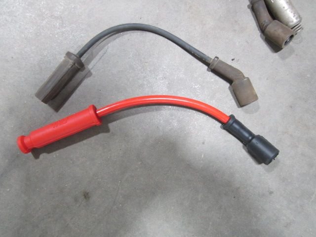

new 10 mm wires
new 10 mm wires
new wires installed
new wires installed

old spark sticks
old spark sticks
