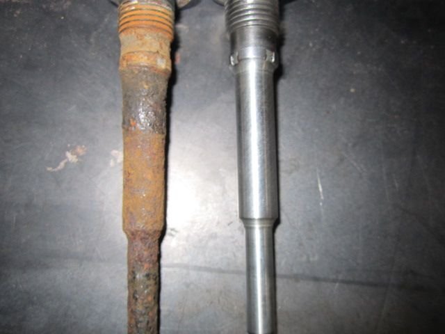

old crusty caliper slide pin bolt

one of the caliper slides was crusty as f so those were cleaned and swapped from the old diff. all caliper slide pins polished and coated with high temp orange silicone grease

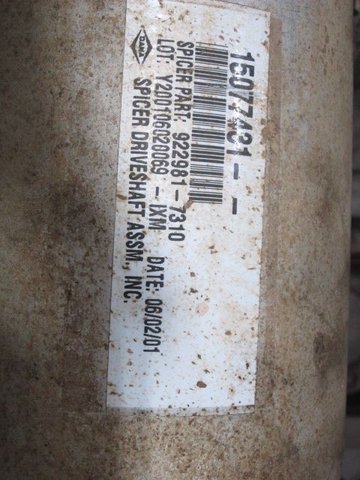

has a vibe / noise at highway speed, leaning towards the front driveshaft- or transfer case- lots of slop at the output shaft to the front diff, seems excessive even with it being a slip-joint connection.driveshaft was replaced at some time, has a local driveline sticker on it.
