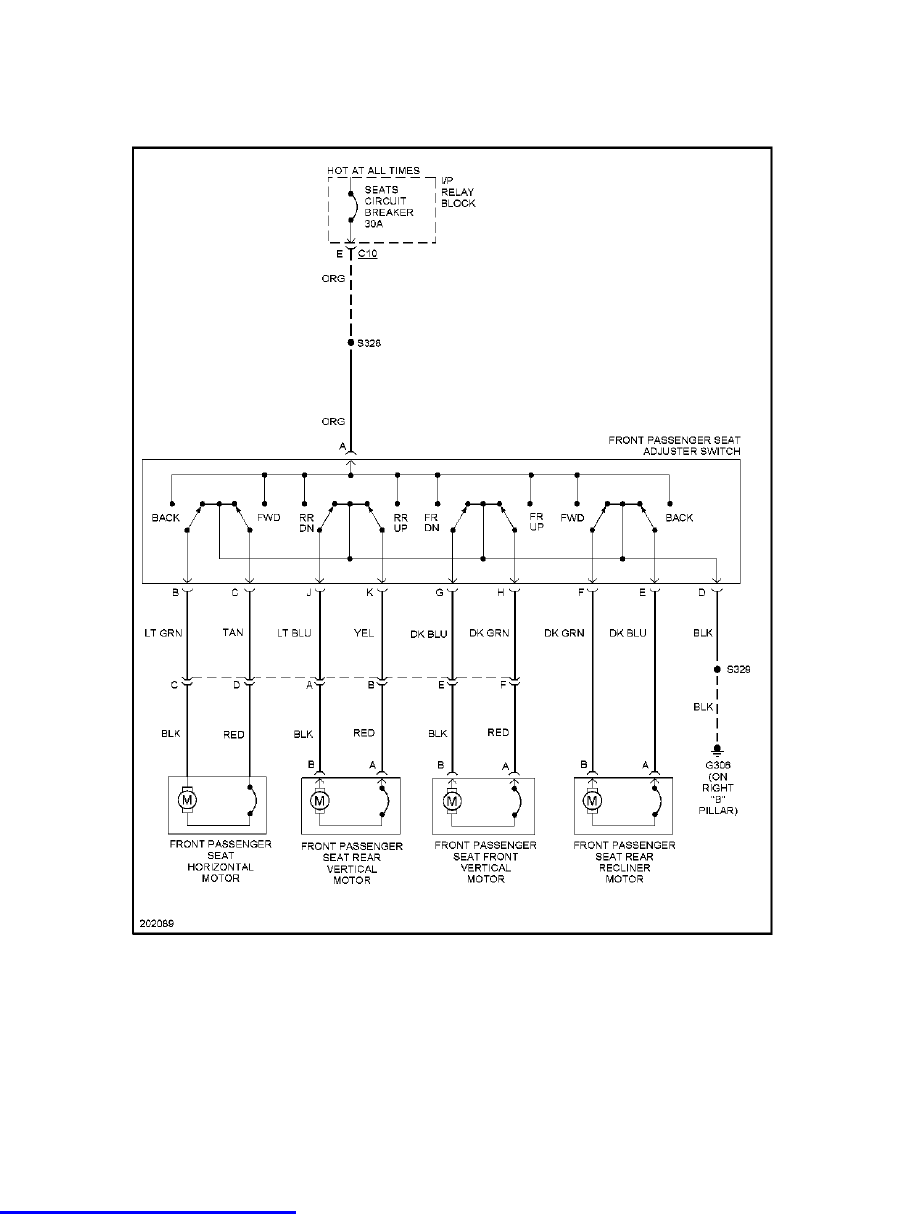

Hey, I bought a 2005 Chevy Silverado a while ago and the passenger seat controls have not been working. I took the passenger seat controls off and discovered I was not getting any power from the hot wire. (Orange) So I ran a 12V wire to the connector and sure enough, the seat works. Anyway, my fuse at the fuse panel is good, and I’m getting power to the hot side of the fuse. So that means the problem is between the seat and fuse panel. It’s worth noting that I also tested the connection under the seat on the main harness, also have 0 power.
I Searched the internet trying to figure out all the connections between the seat and fuse panel, so I could test each one. I was hoping someone here has wisdom they could share to save me from ripping apart the truck figuring out myself.
POST NOTE: the passenger rear window does not operate. We put a new regulator in and still no action. Wondering if the 2 could be related.
which fuse did you test?
You have a photo of what I think is the underhood fuse block. But the diagram you posted shows a 30A circuit breaker in the instrument panel relay block (under your dash)
you might want to check out gmupfitter.com
There are schematics, pinouts , and harness routing for your truck.
this might be it:
https://www.gmupfitter.com/wp-conten...Electrical.pdf

I just noticed you have the S/R fuse highlighted in your photo. Is that the one you tested? That's for the sunroof.
The one you want is MBEC 50A right at the top. That feeds the seats circuit breaker.

thank you. I’ll be sure to check it out. I accidentally included that photo. I did test the 30 amp fuse as well.
They should be described in your owner's manual.
yes, I accidentally included that photo. Thank you. When I bought it I didn’t get a device manual. I will be sure to check that 50a.

what 30A fuse? You mean the Seat circuit breaker
Please be specific when describing your troubleshooting.

my apologies. I’m just a stupid 17 year old. Never worked on anything newer than the 80s. It was the metal 30A under the dash. I should’ve specified circuit breaker. I understand the frustration.

alright so if you measure 12V on both sides of the circuit breaker, and theres no power at the seat connector, then the problem is in the wiring in floor.
a circuit tracer might help here in finding it
