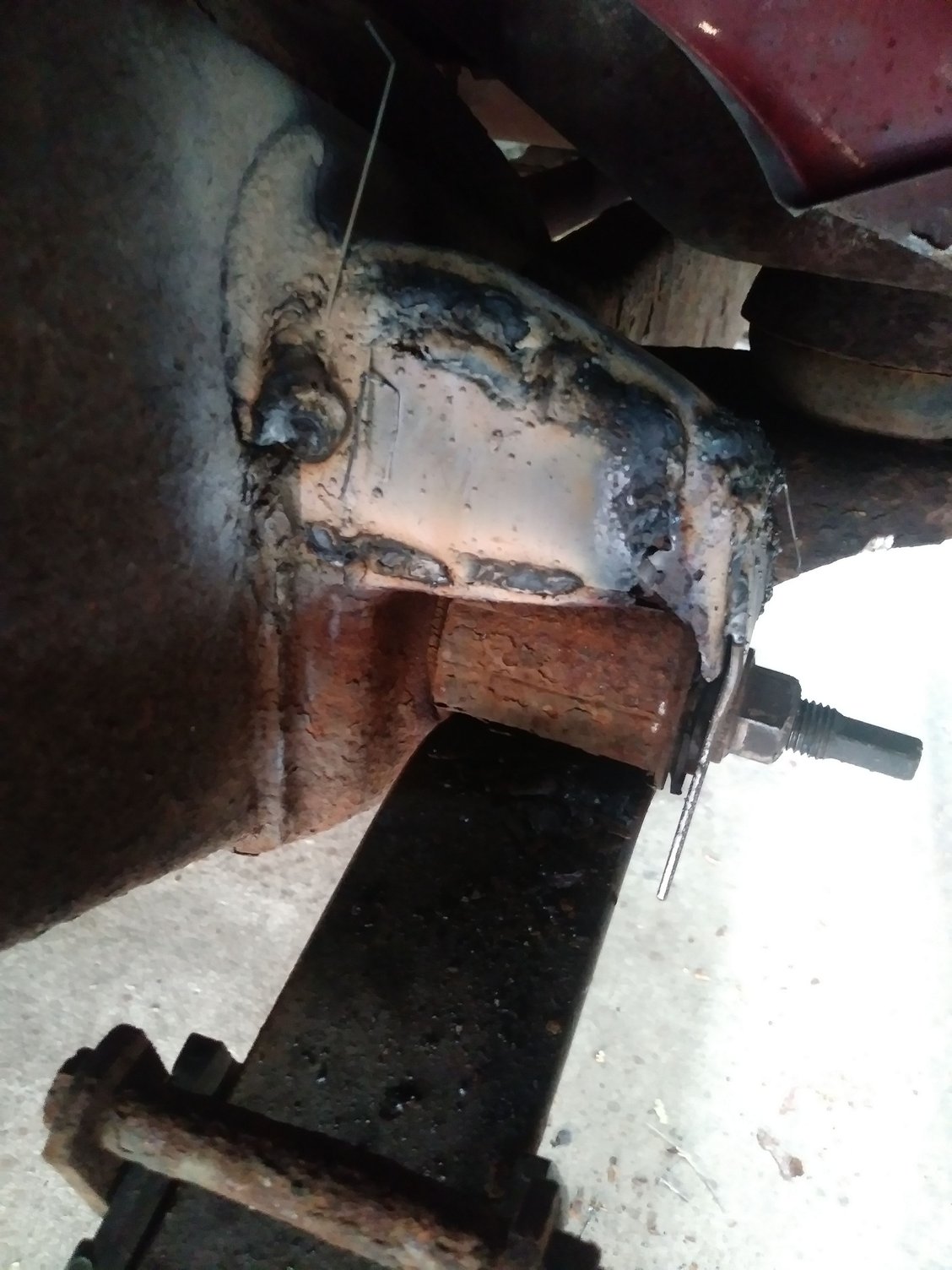

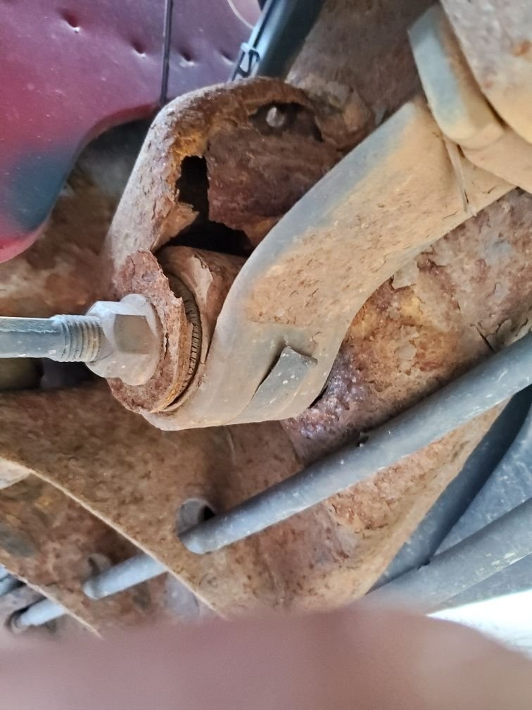

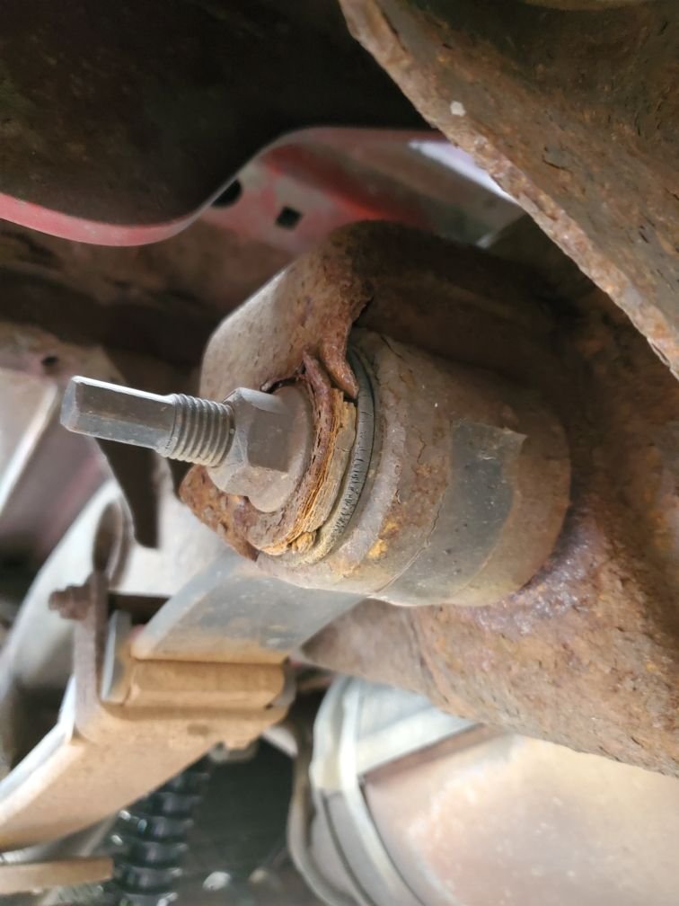

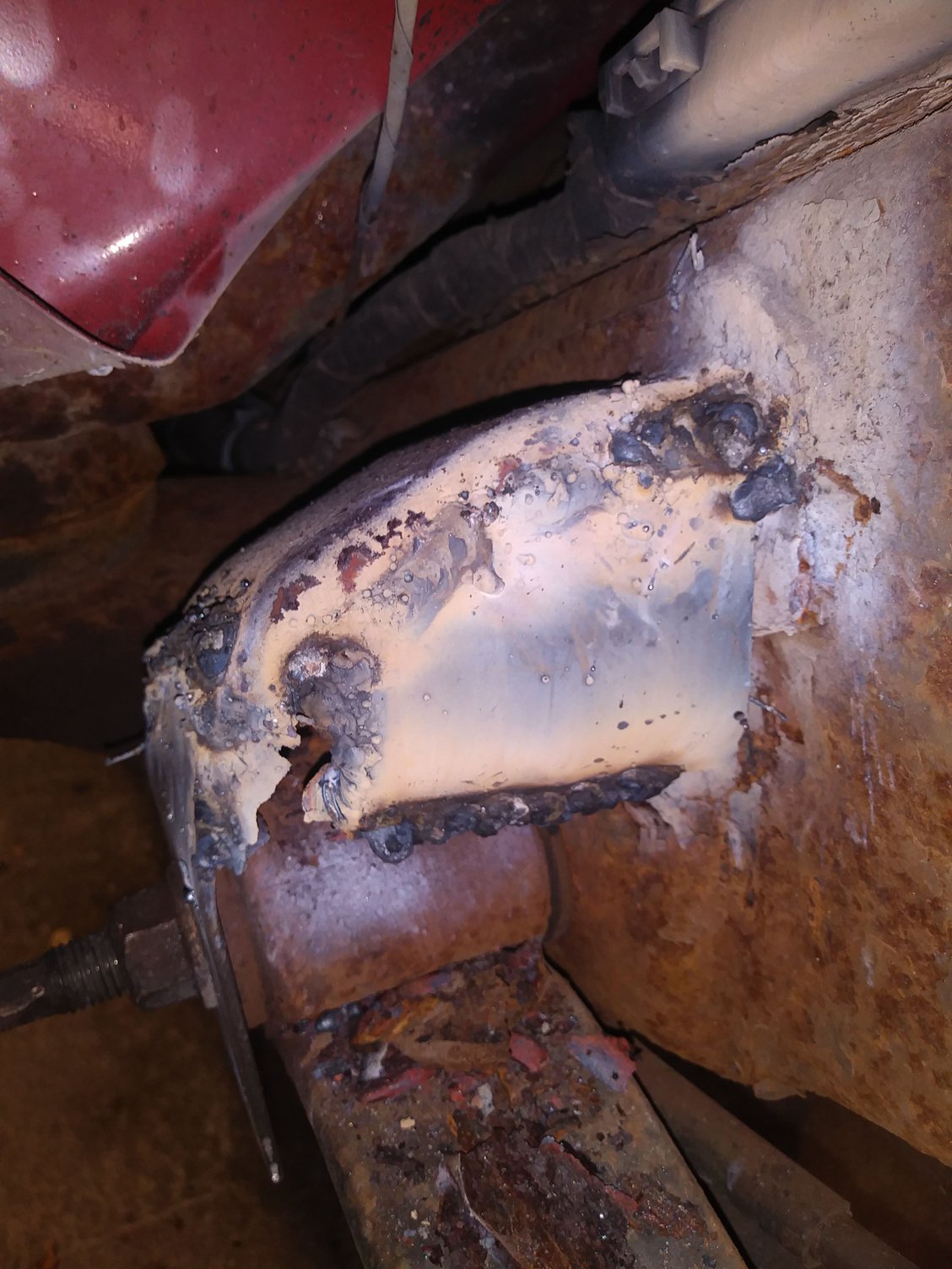

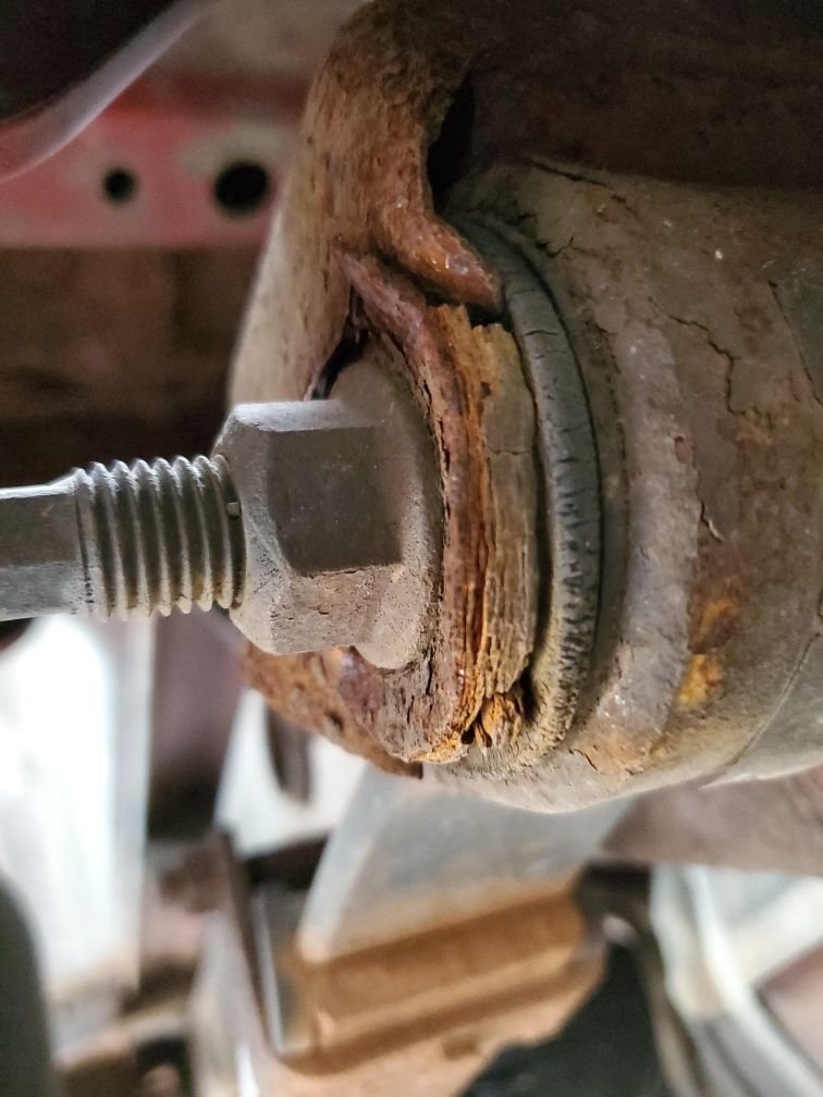

ok for anyone interested. today o got the truck in the garage and it was bad. both sides were rusted but the drivers side was worse. so i fabbed up some 10 ga metal around the outside over the stud and then welded some in on the spring side to fill in the rot that was there. not a real bad job but for the 100 deg heat index i had to deal with and my old mussels are not used to the bending and twisting anymore so now i'm a sore puppy.
here are some photos weld was a wire feed look bad but i did have good penetration. you see the flux. but if anyone has to do this maybe this will be some help. can't say how long this will last and he may have to find some aftermarket ford or dodge bolt in mounts and we will them make them fit. but we will see how these hold up first

passenger side leaf end
pass side stud end
d-s stud end
d-s leaf end
d-s stud end top
