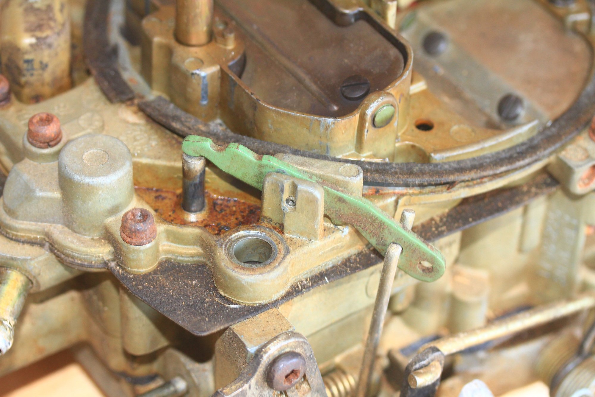

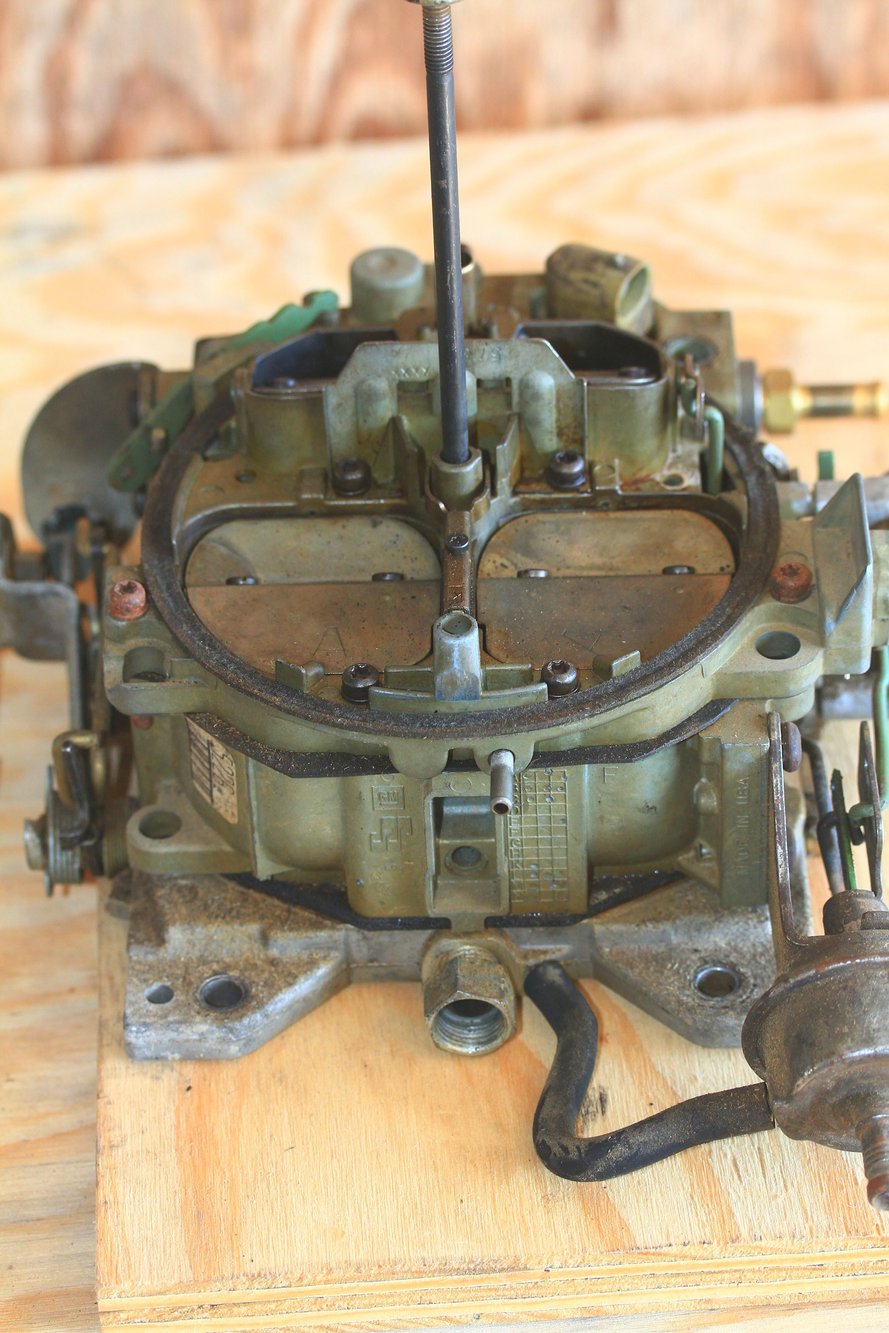

Hanky,
Thank you so much for trying, I really appreciate it. I have purchased a Hygrade kit, and it does have the scale for float height, but the instructions are not not real good. I guess they cheaped out on that aspect. the diagrams are blurry and in some areas illegible. but I think between the pictures I took and online sources I will be able to reassemble without to much difficulty.
I have decided to go whole hog on the rebuild and hope I can either tune it myself, or else find someone to do it. If that doesn't work, then I will be looking for a Holley.
Current status is I have fully disassembled the thing, soaked it in a pin-sol solution,(that didn't seem to do a lot) gently soda blasted it, and cleaned with carb cleaner. actually looks pretty good at the moment.
I have ordered some more parts; new accelerator pump, brass bushings for the throttle shafts, choke pull-off, etc. when that arrives I will start the rebuild.
In the mean time if any one has any advice on tuning, I would greatly appreciate it. You said there may be special tools involved, I have the adjustment tool with the double D head, is there anything else I should try to get? Vacuum Gauge etc.?
Here are some pictures of the process. Just realized I don't have any pictures after soda blasting, will try to get some of those tommorw.
