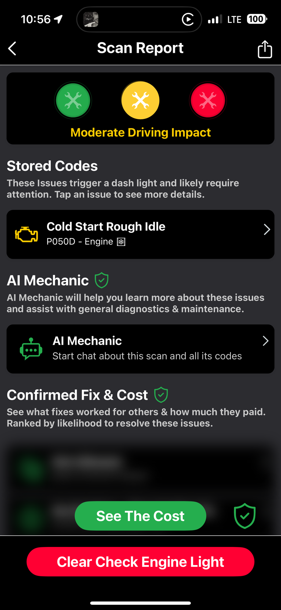

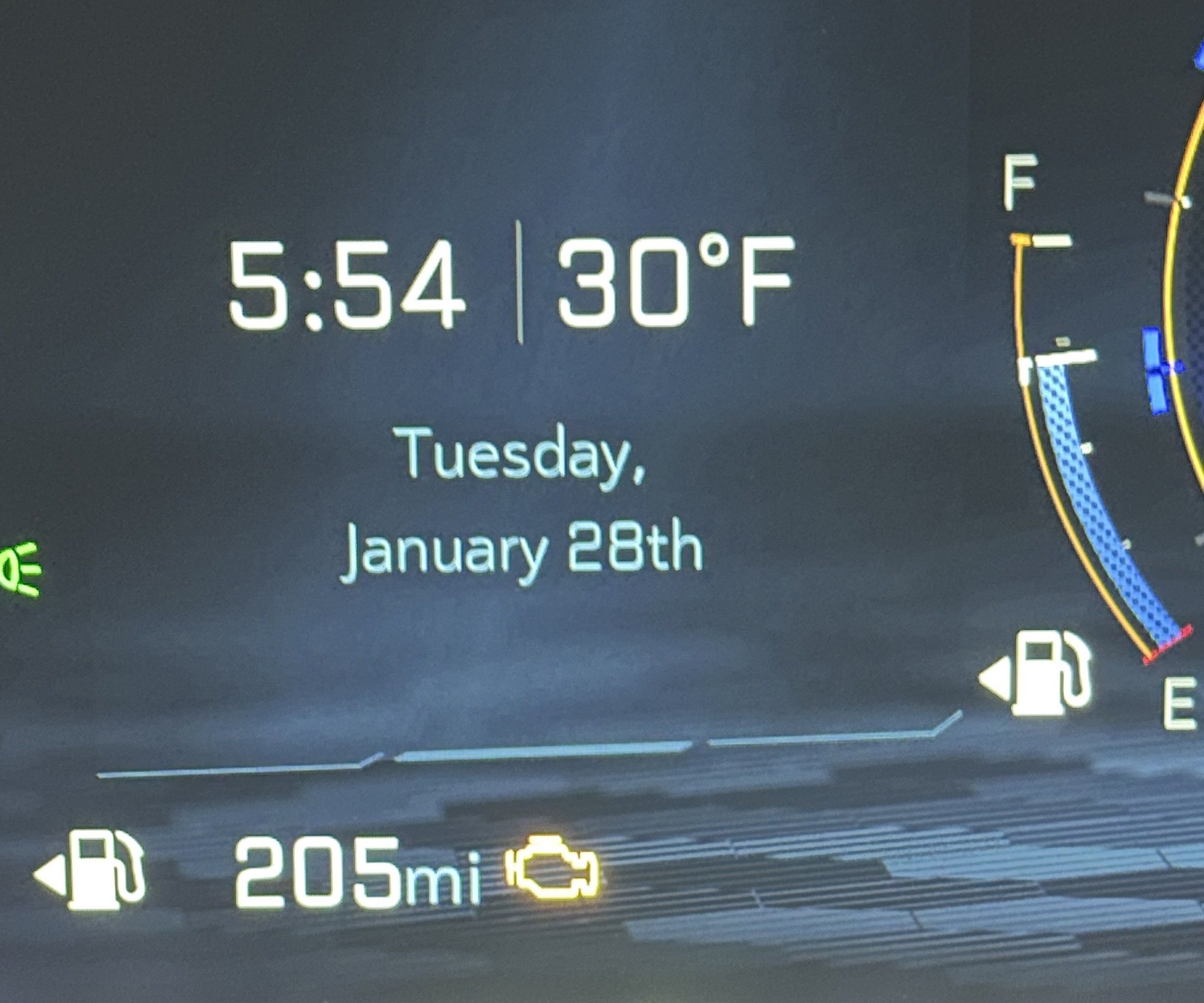

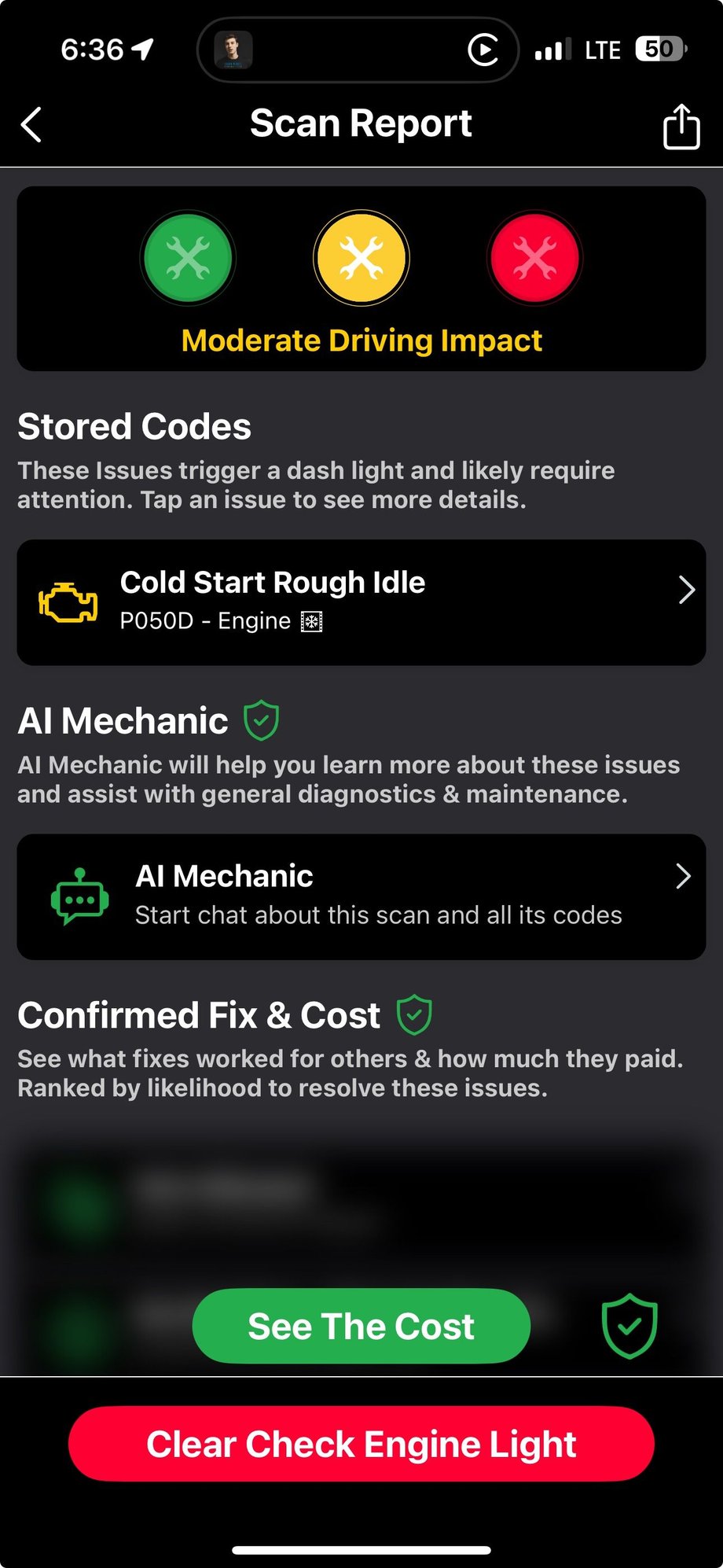

Just to add another one with same issue. The light comes on, then goes away after a day or two. Remote start won't work when the light is on.
I was able to check it at home, then I went to the dealer. I was told they tested the injectors and ended up changing three of them. Few days later the light came on again. I will go back to the dealer, but I was told on the phone that GM let them know that something is going on with the cold weather ???
The service rep said that I should contact GM customer service.
