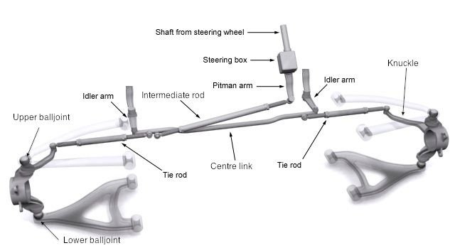

I can only find 11 fittings to grease (5 on front drivers side and 6 on passengers side) but i seen somewhere they said theres supposed to be 12. Its a 2 wheel drive with a 4.8. Is there a fitting hiding in one of the ujoints?
Old Jun 1, 2024 | 1:28 PM
here are some areas you can check...
Steering linkage:
- Pitman arm to intermediate rod (x1)
- intermediate link to centre link (x1)
- Centre link to tie rod (L+R)
- Tie rod to knuckle (L+R)
- Idler arm (L+R)
- Idler arm to centre link (L+R)
* some idlers only have 1 set
Suspension:
Upper balljoint (L+R)
Lower balljoint (L+R)

... and yes driveshaft u-joints often have grease fittings too
