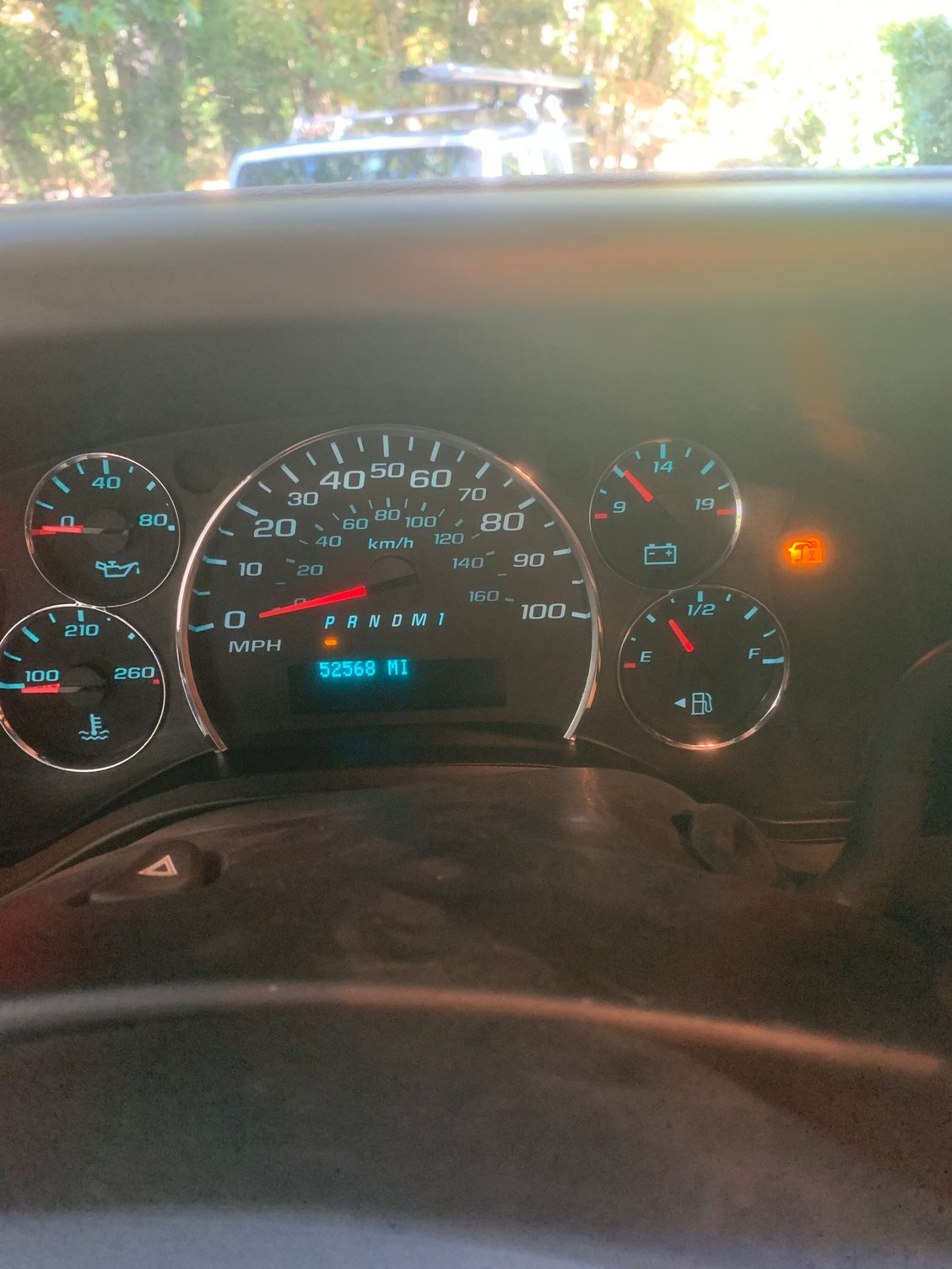

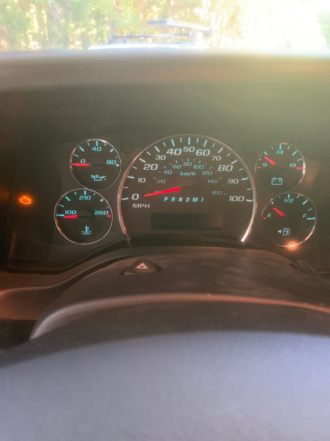

New key…same results. Is there a chance these symptoms could be related to something other than the antitheft? When I first put the key in without turning it, the antitheft indicator stays on after the other lights turn off.(first picture) when turning the key, all the lights go out except the engine symbol.
