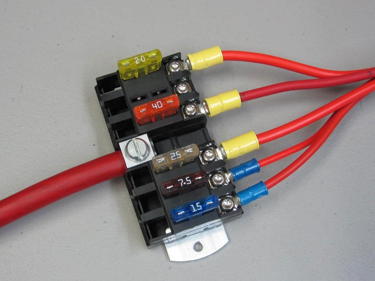

However, at this point - with the amount of modifications I was planning and my dislike for that fuseblock location, I just decided to build my own fuseblocks using fuse strips.
Old Apr 18, 2022 | 2:21 PM
just mount an aftermarket fuse block
