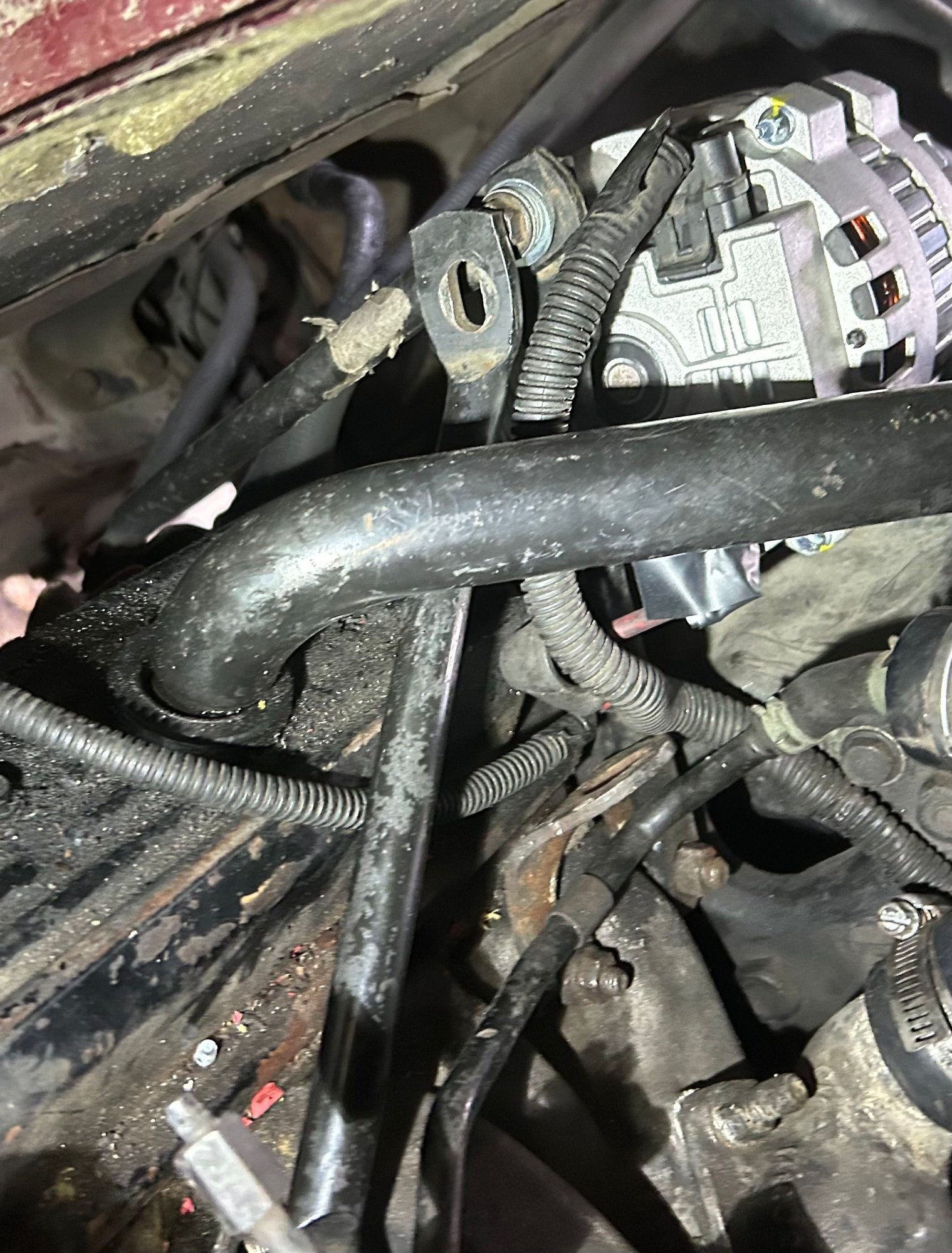

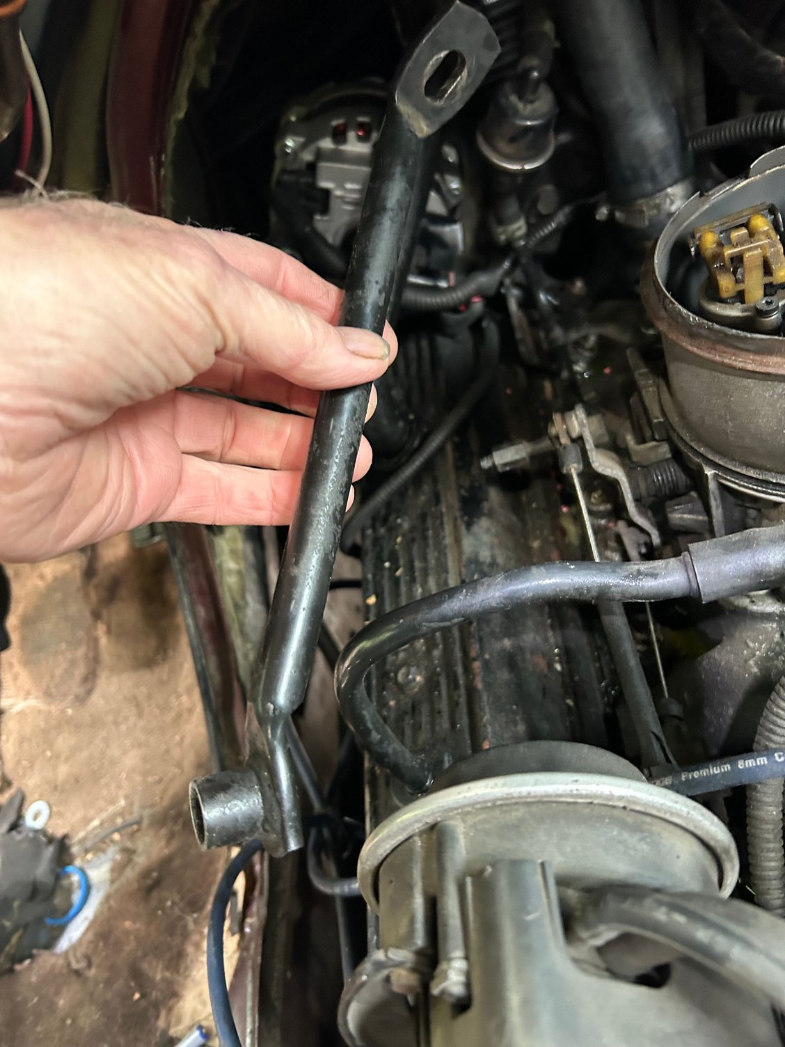

Well, this is embarrassing. I remember removing and reinstalling this part about two years ago when I took the intake manifold off, cleaned up and replaced the gasket.
A few days ago, I had to replace the alternator. I put it all back together, suddenly had the forehead smacking "whoops, where does this part go" action. This kind of dumbassery can only sort of be ascribed to 'senior moment' action.
The mind boggling part is can't find anyplace it would attach. I don't recall removing anything except the three bolts holding the alternator on and the two elec. connections, of course.
Little bit of anxiety here, it's a strong support piece, hard to imagine that it won't be missed at various moments.
I've told people for years to always photograph from several angles before you disassemble and while you are disassembling. Note to self...

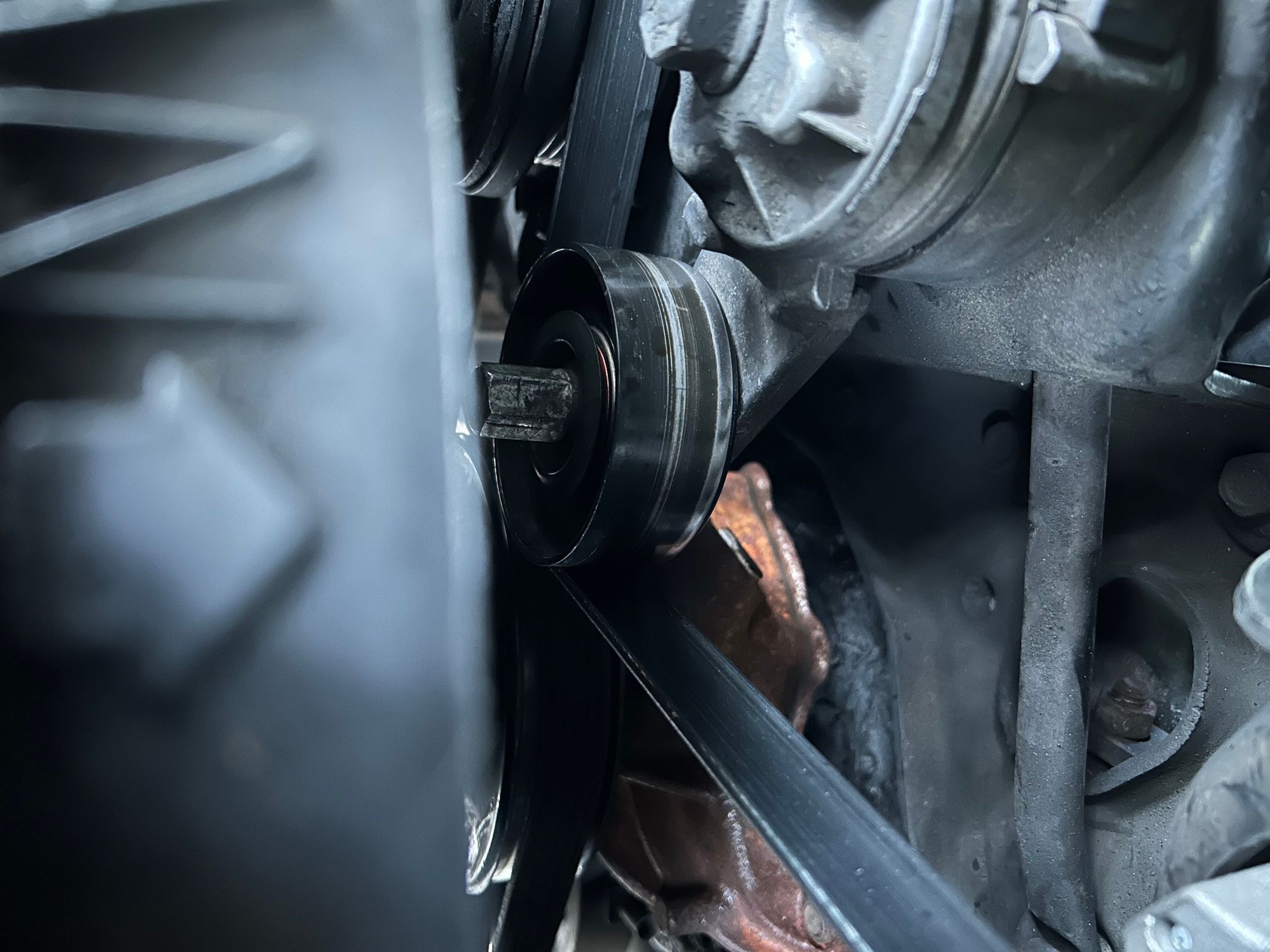

This is a support for the bracket holding the belt tensioner. The part with the big hole is where the screw holding the belt tensioner goes through. The other hole goes on the left handside bolt looking from the front holding the thermostat housing.
You have to loosen your belt, remove the belt tensioner, remove the nut holding the thermostat housing. Then wiggle in the support bar. Reinstall the nut, belt tensioner and belt and you are done.

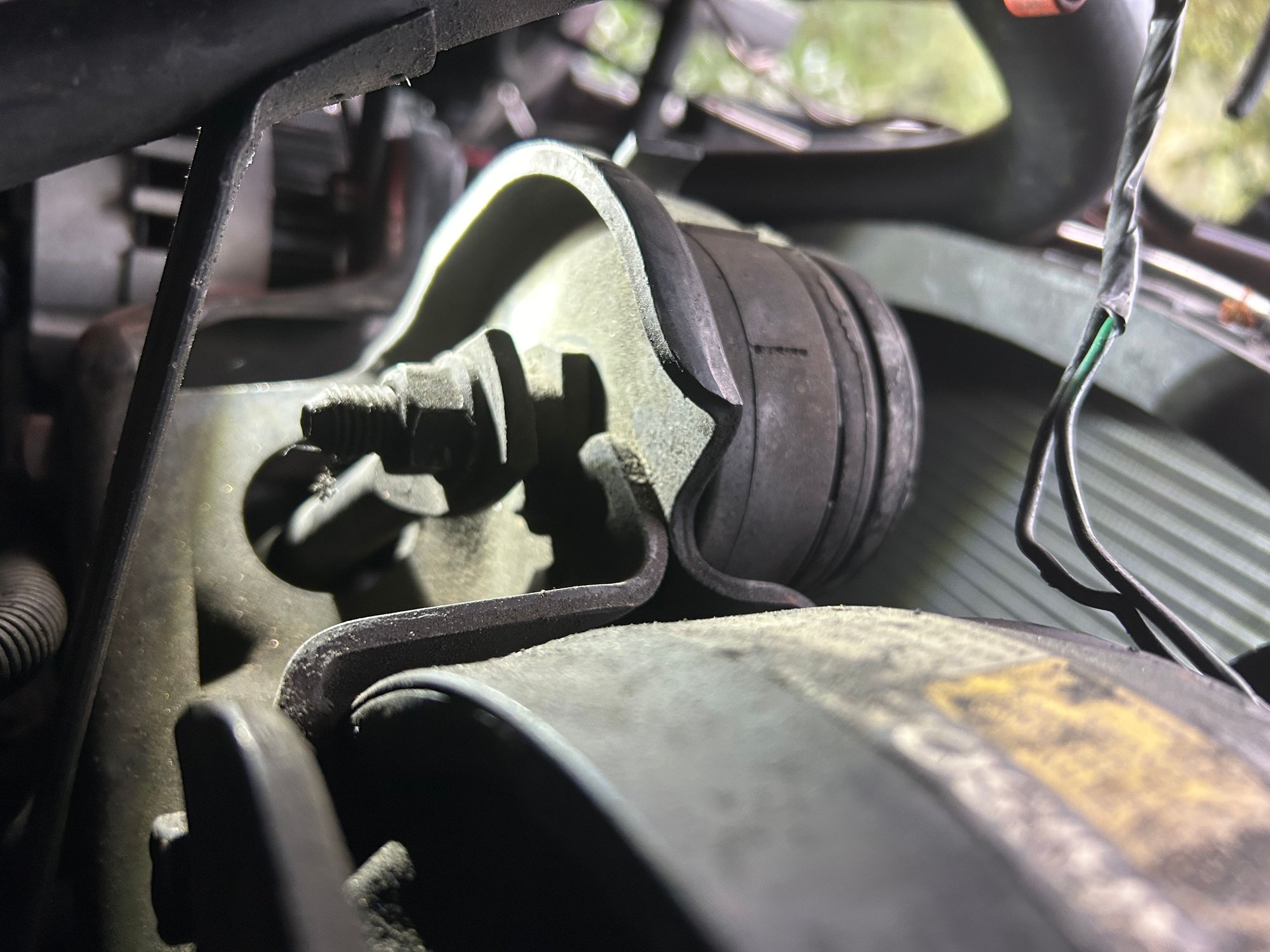

Thank you for this, but that part is still intact. It does look a lot like the mystery part I was holding. I'm glad that was not it, I didn't want to have to remove the serpentine belt again.
I finally figured out where my part went, I'll put that in the next post to keep the photos tidy. Here is the one you were talking about:

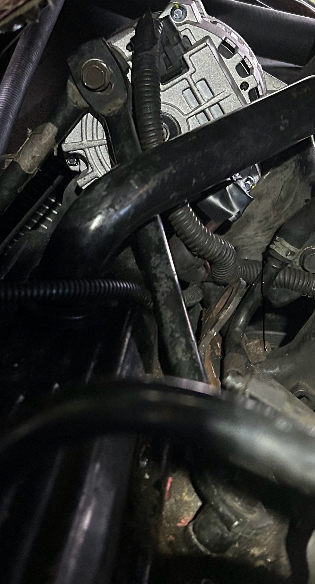

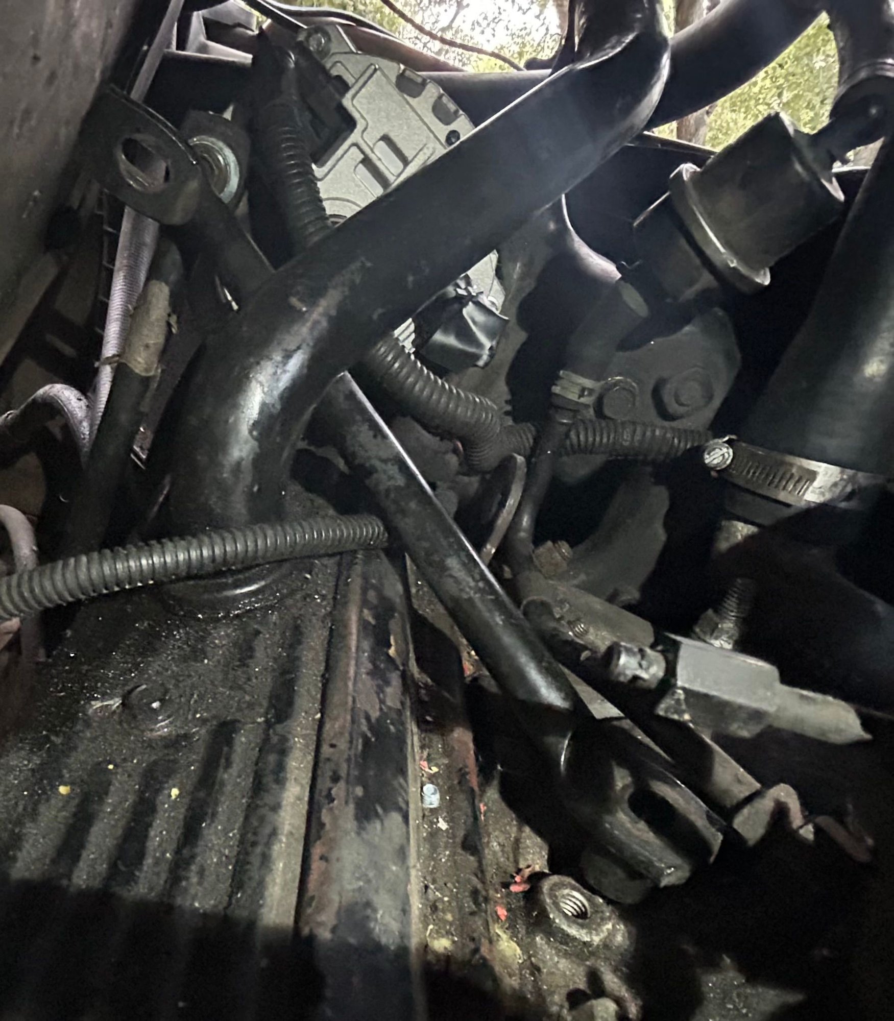

Memory is a funny thing. I had to work out it a bit, but I was able to retrace my mental steps. I was certain that the only parts I had disassembled related to the alternator mounting points.
I had noticed an empty bolt hole on top of the intake manifold, but it was pretty dirty, so I thought maybe it was an old unused hole. No, in fact that was the clue The whole thing was slightly tricky because the part passes under the long oil filler tube in order go up and attach to one of the alternator holes. Here are before pics.

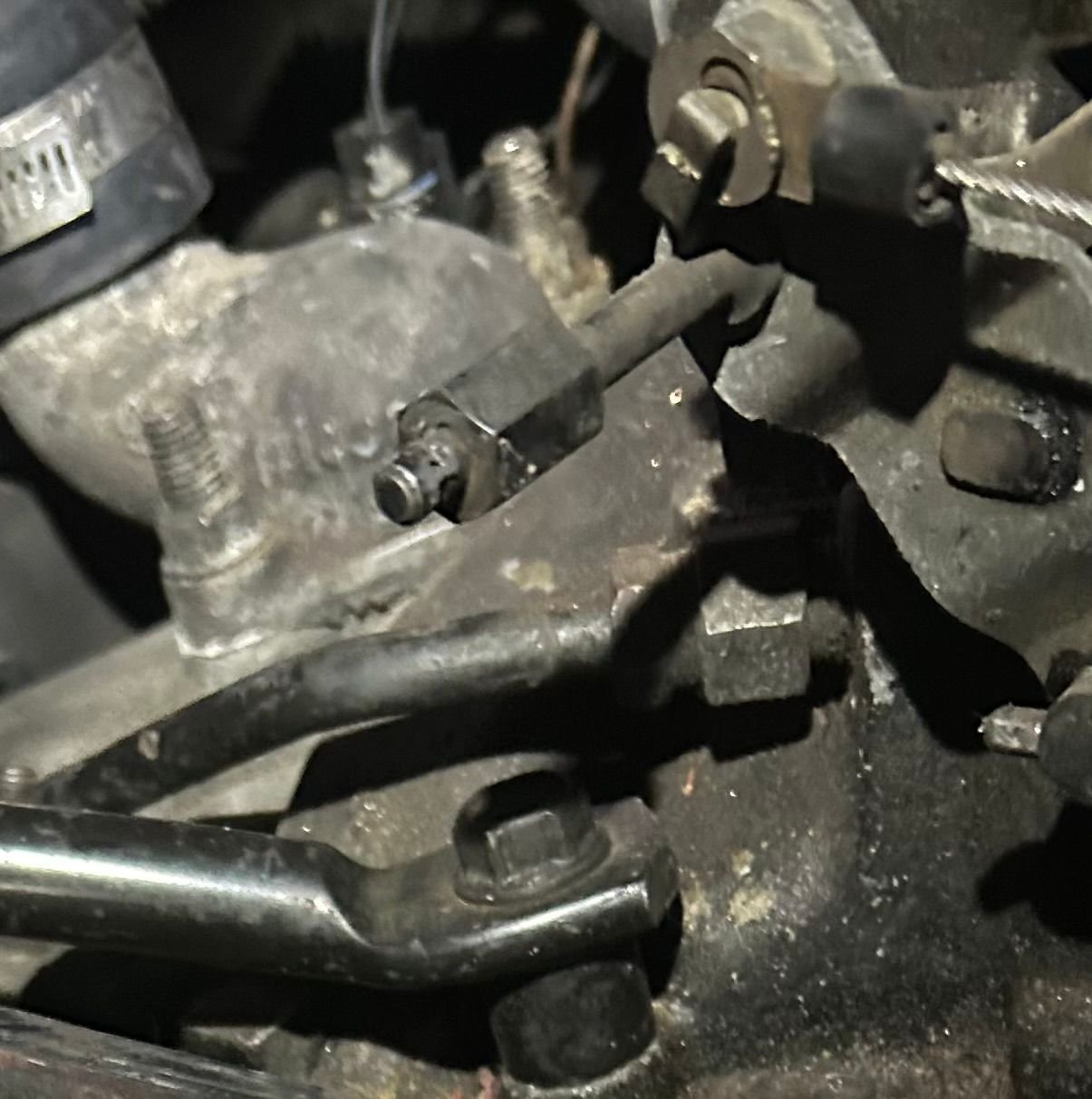

Default Victory is mine!
And the after pics. I am of course, glad I found this one. I don't think engineers put stuff like that in to pad their hours. I had taken the alternator out because of some serpentine built trouble. In December I lost the belt, the tensioner pulley was an older style that had a nylon center part - it self-destructed, went past its pull date. I was 50 miles from home. Luckily had enough tools with me to do the job on the spot.
