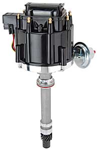

this is the HEI coil in cap style, otherwise your distributor will have only the plug wires coming out of it and be smaller

that is it and the chrome part is what is hitting the manifold and thank you for the help
