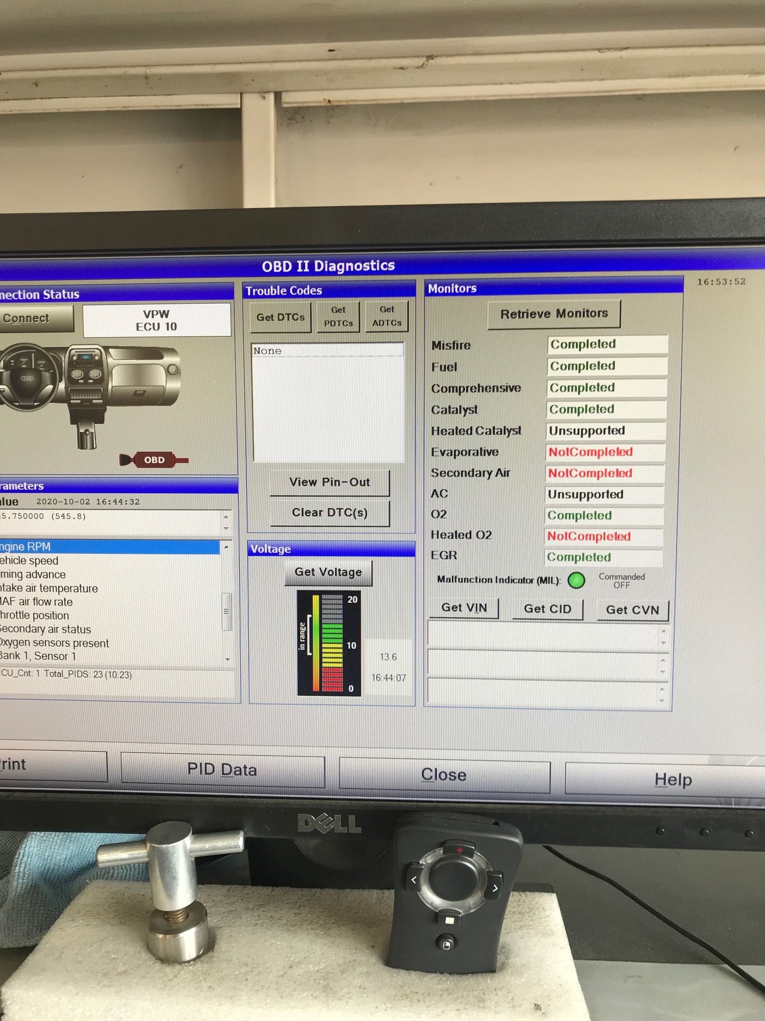

the tech said the secondary air is the one we need to flash and the he can help me fix the heated o2. he said at that point we wont have to worry about the evap....any suggestions to get that secondary air to flash or how to fix it? below is a pic, thanks!

flashing refers to reprogramming a module; not related to what you are doing. you need to get a monitor to run and complete.
the secondary air monitor will not complete until the heated 02 sensor monitor runs and passes. it needs data from a working 02 to do it test. the monitor will be inhibited until the o2 pass. fix the o2 and the air monitor will run
thanks! I’ll look into those sensors. Odd because The check engine light isn’t flashing. I’ll take it to auto zone And borrow their obdII to check for any codes flashing. Maybe I can just clean the sensors and see it’ll get it to work.
