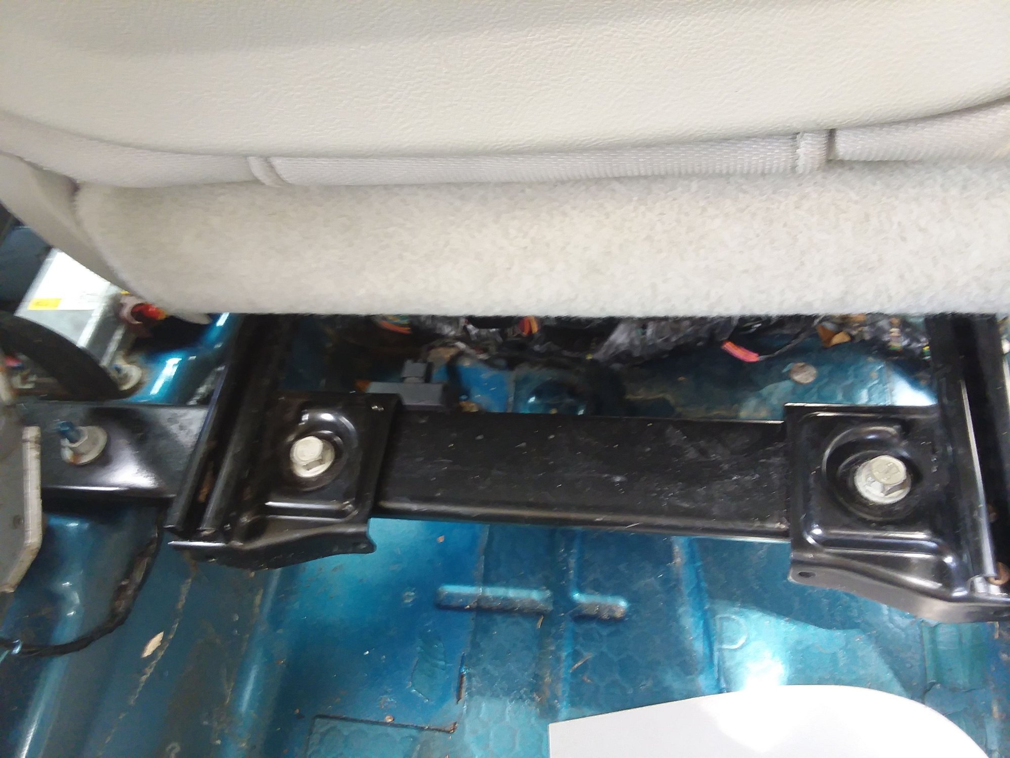

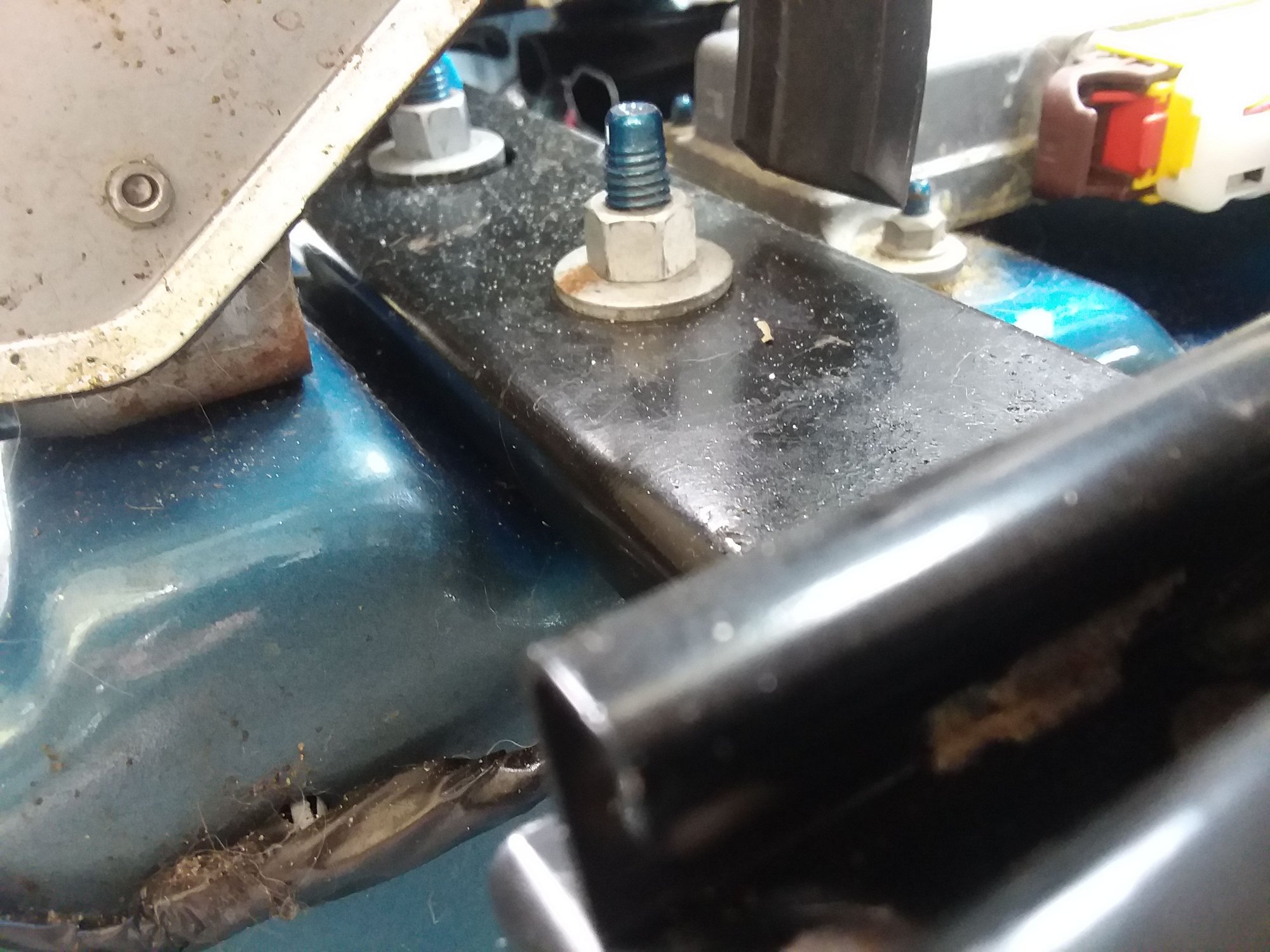

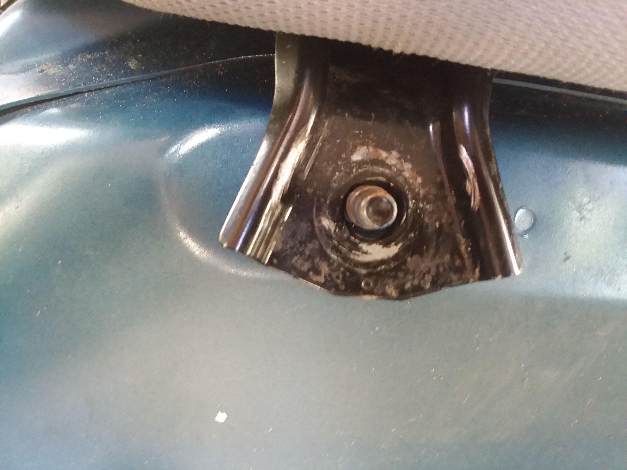

Old Sep 23, 2019 | 2:29 PM
Tokin1's Avatar
Joined: Sep 2019
Trim removal tools
front seat bolts
Seat bracket bolt
Seat bracket center nuts
Back seat nuts.
Mine did the same thing. Extremely easy fix.
I used air to blow the drain clean from under the hood. I also used a large shop vac to help remove any debris. If you feel the need to clean the coil its easily accesed thru the center ac vents on your dash. I would suggest using both air and suction to get the drain clean.
Now for the good and baf news on your carpet.
your carpet is easier to remove than you think. FIRST DISCONNECT THE BATTERY.
Next you need to remove all the lower trim panels. You will also need to remove the bolts that hold your seatbelts to remove the side pannels. Buy a trim removal tool kit. Very cheap but very valuable.
​​​​​​Next, your front seats are super easy to remove, so easy a caveman can do it, 2 bolts on each seat. Tip the seats forward and unhook the seat electronics on both sides and slide them out the back with the back seats folded down.
​​​Next remove the seat bracket, 2 bolts and 2 nuts, super easy. Last you need to look at the base of your back seat. You will see covers that protect 4 nuts. Remove the covers and remove the 4 nuts and your back seats now fold up making it now possible to fully remove the carpet. Be careful not to tear any of the foam rubber in the process. I was able to totally dry the car and I had to use an ozone generator to get rid of the smell from multiple people dumping soaps and deodorants on it.
the good news is these carpets can be removed, cleaned and replaced I a matter af a few hours.
The bad news is no one makes aftermarket carpets for the HHR so all you have is new old stock. The cheapest I was able to buy a brand new carpet was about $500 shipped. At the dealer theyre $426+tax if the dealer can find one. It depends where you live as to what dealer may have one available.
Third choice is to bone one out of a junk yard. Took me about an hour to remove mine.
hope this helps.
