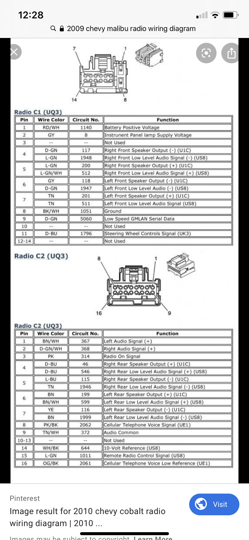

are you using a harness adapter for the stereo, or are you following a stereo pinout?
Are you following a wiring diagram or pinout for the vehicle audio system?
Maybe provide some photos or a sketch of what you're doing.

This is the factory wiring diagram
