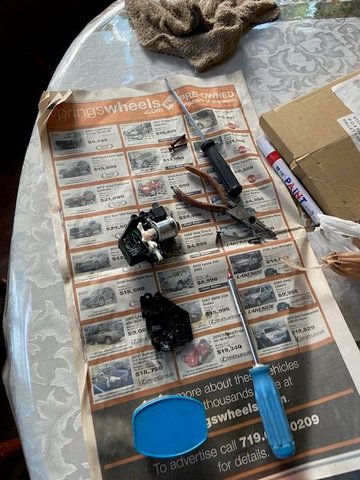

The problem part was discovered to be the Shift Interlock Solenoid/Switch (Dorman 924-978?) sticking.
But I didn't have to buy a new one.
I found mine, the white button was gummed up with spilled soda/coffee, which kept the white button from popping out fully when the car was in park.
In hind sight, I probably could have fixed the sticking with electric contact cleaner spray or just rubbing alcohol dripped over the white button while pushed in and out. But I couldn't see that for sure till I took the interlock out and opened it up to inspect the inside.

Once removed, you can remove the 2 short torx screws to open the box up. It just has a center seam.
Inside there is circuitry which knows when the white button is in or out, Also there's a micro switch which is pressed if both the white button and the solenoid are pushed in at the same time.
I didn't look at a wiring diagram. I can say that the ignition key will not come out if the wire harness is unplugged from the box or if the button is stuck in(like it's not in park).
Use a wet rag to clean out any soda/coffee residue.
They spray with some silicone spray and/or apply some vaseline, to the moving parts.

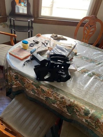

If there is much spilled coffee/soda under your entire shifter frame, you can remove the whole thing for cleaning etc. by also:
Use a flat screw driver to pull up the flat metal U shaped retainer which is where the shift cable enters the front of the shifter frame.
Use 2 flat screw drivers to pry/pop off the shifter cable end off of the retaining ball.
Pull forward out the shifter cable from the shifter frame.
Use a 1/2" deep socket to remove the 4 floor shifter frame retaining nuts.
With the shifter frame removed and upside down, lightly silicone/wd40 spray any shifter moving parts pivot points hinge.
*When reassembling, stuff some strategically placed and folded paper napkins under and inside the floor bottom of the shifter to catch/contain any future liquid spills...
