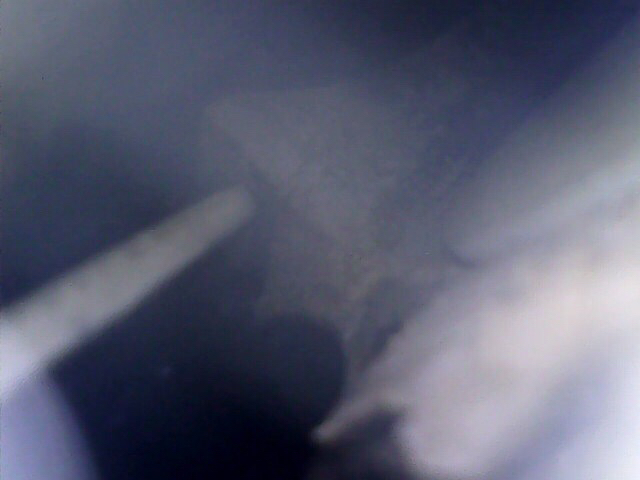

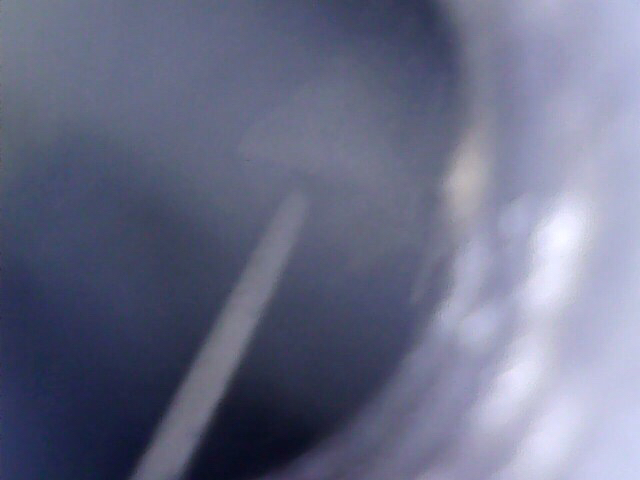

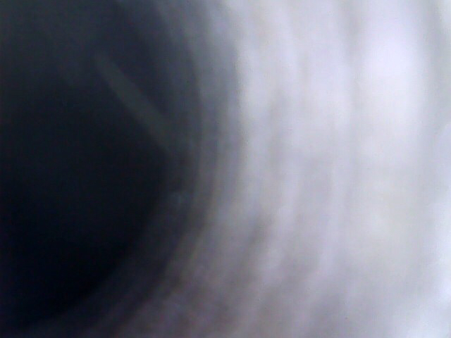

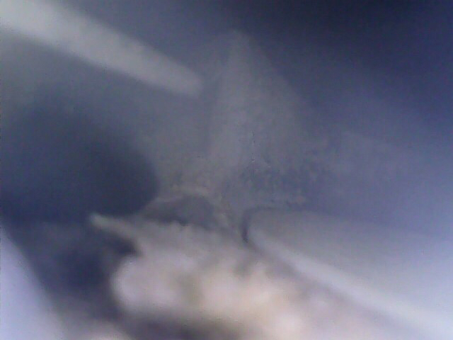

I just got a few here. Not sure what I'm looking at Name:  photo214.jpg

Last one looks like a partial of a valve seated. If you can get lower in the cylinder looking to the top

I see it now. Is the 1/2 circle on the left side showed the valve is gone? It is going to be hard to get the camera to point up...

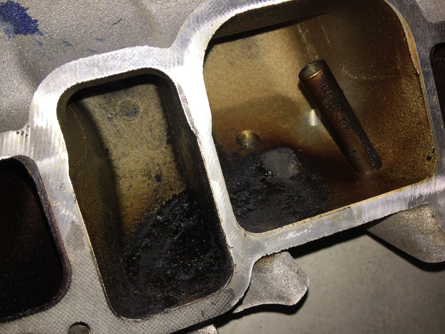

From: Snowville
I got some burnt marks on the opposite manifold chamber. Is there a relationship?No compression trouble shooting-photo756.jpg
