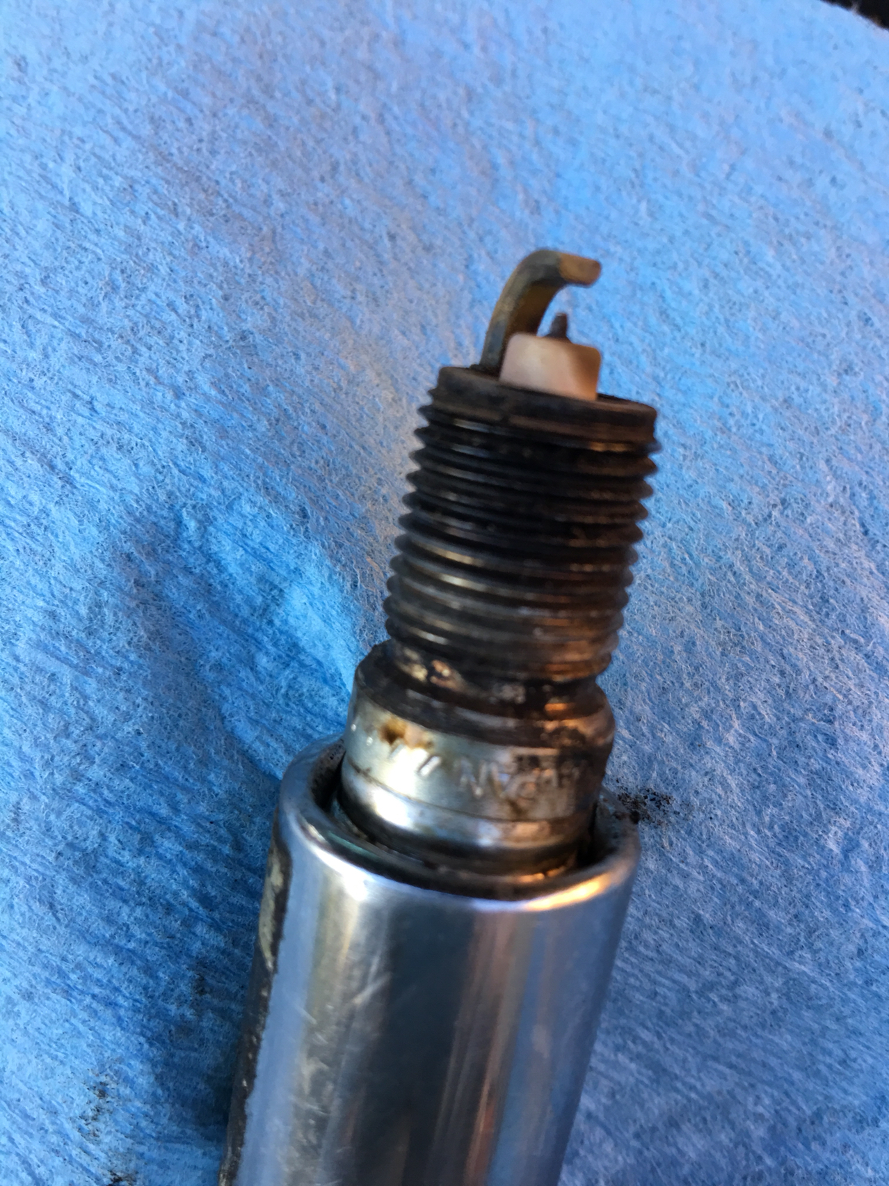

Old Jun 19, 2017 | 11:36 PM
V12TT's Avatar
Joined: Mar 2017
Posts: 103
From: Snowville
I pulled the spark plugs. No compression plug is on the right. Plug from good cylinder is on the left. Any thing obvious?
Closer looks at the plug from no compression cylinder:No compression trouble shooting-photo127.jpgNo compression trouble shooting-photo225.jpgNo compression trouble shooting-photo442.jpg
Also I need to mention that I can remove the plug from the no compression cylinder with bare hand. It wasn't torqued down at all.

Old Jun 19, 2017 | 11:42 PM
V12TT's Avatar
Joined: Mar 2017
Posts: 103
From: Snowville
Here are a few images from the zero compression cylinder. I don't know what I'm looking at. Please let me know if needing more imagesName:  photo264.jpg
