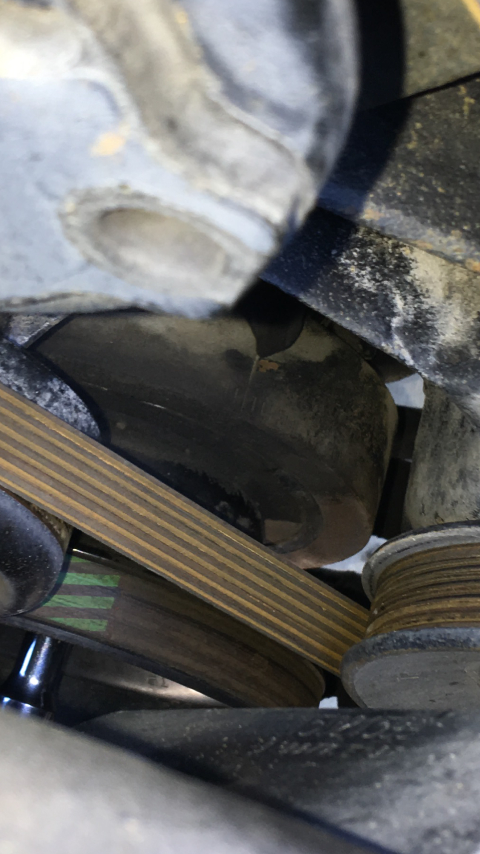

The TDC is correct Camera View

Put a piece of kleenix in the spark plug hole (if are doing this by yourself), spot crank the engine over till it blows out the kleenix. That will put you on compression stroke, set the distributor to that. You need to ensure the timing is 1-8-5-6-whatever and follow that clockwise looking on the top of the distributor (I think with chevy it's clockwise) the firing order. Again the points should be breaking with #1 cylinder rotor pointing at #1 inside the distributor cap

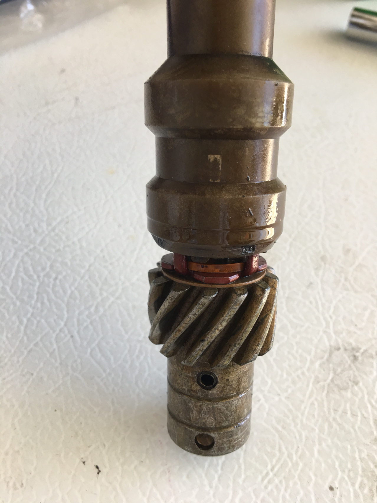

I haven't touched the rig until today. I believe I got the TDC correctly with the compression gauge but I'm so lost on distributor install.
Here's what I did:

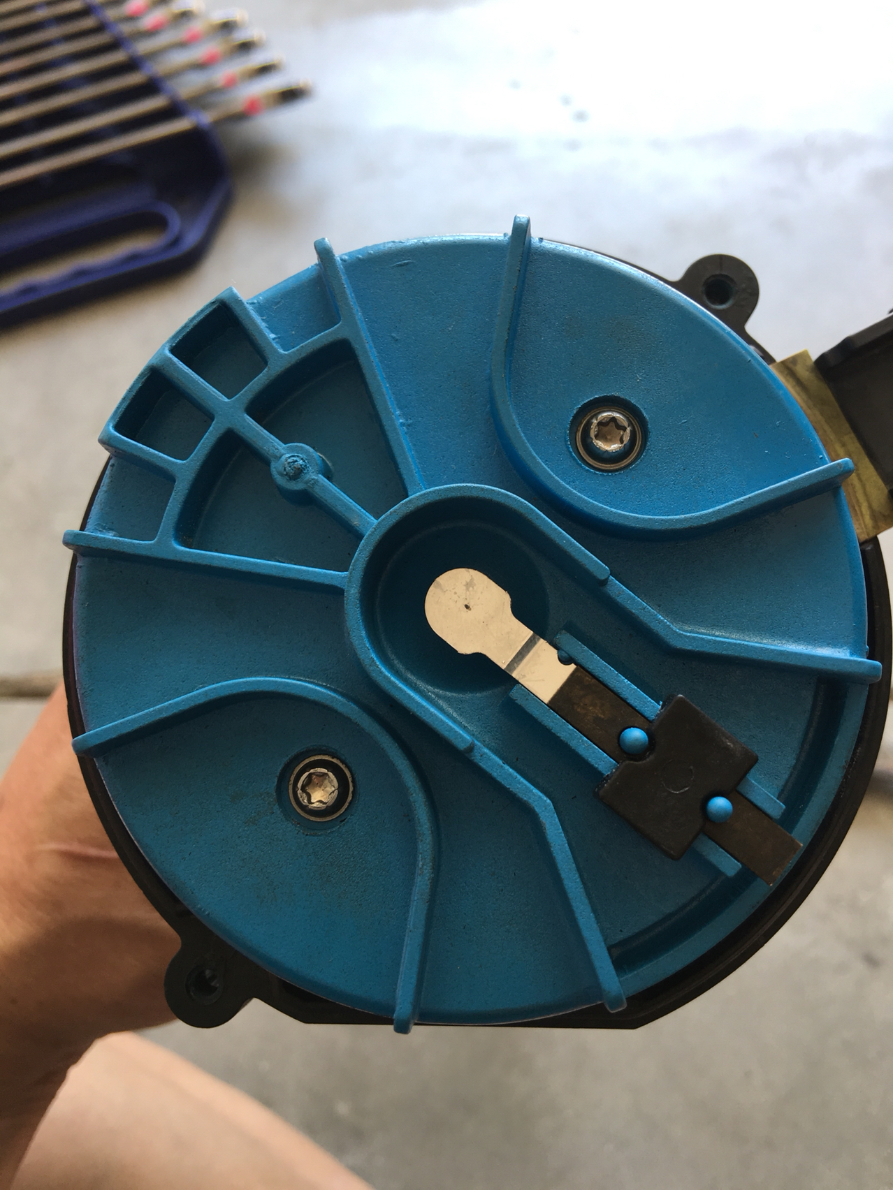

2. In that position, the marks aligned like the following No compression trouble shooting-photo215.jpg

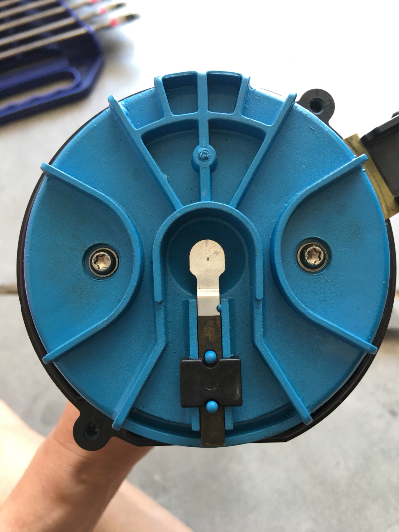

3. After the distributor fully inserted, I got this position which is wrongNo compression trouble shooting-photo774.jpg

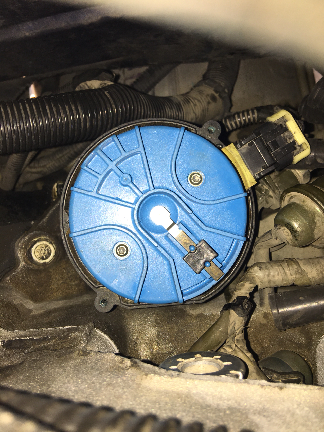

I need it to point to #8 on the distributor cap and it should point toward cylinder #1 at 5o'clock position such as this position No compression trouble shooting-photo484.jpg
Does this mean I damaged the distributor?
