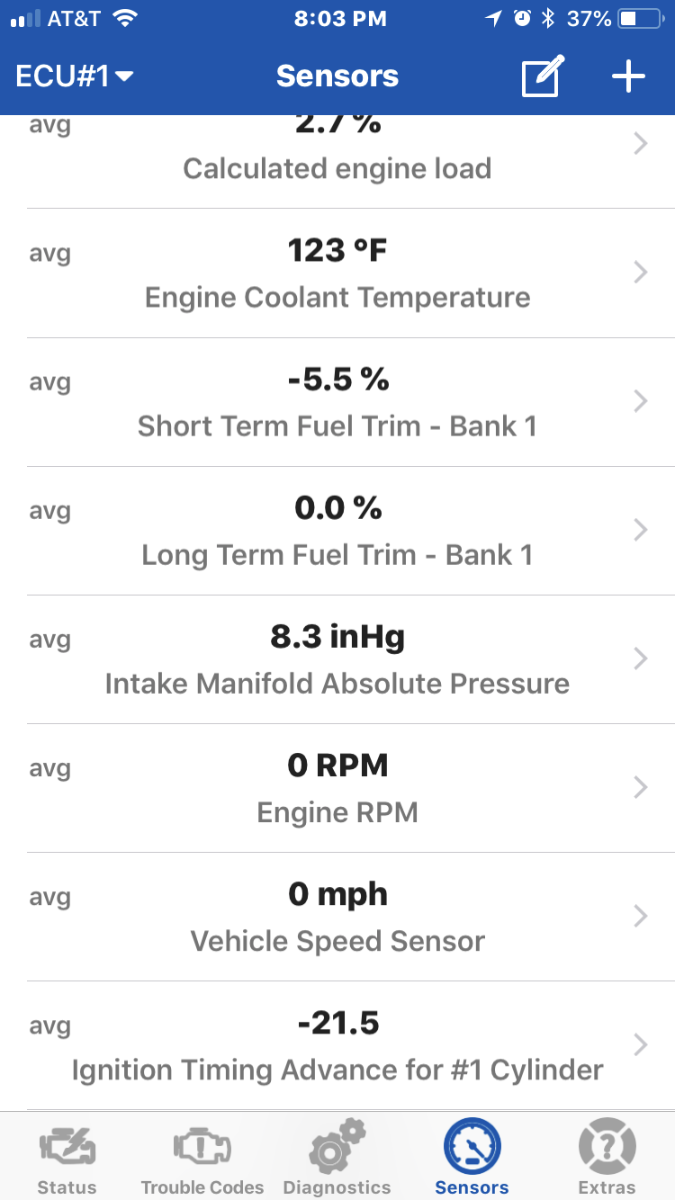

These are the last freeze frames from when the code has shown up. P0172.

Yikes,where's the timing at?

And ft's at idle,still low?

-21.5 cylinder #1 but the engine in my truck doesn’t have an adjustable distributor. Tried that route already. It goes in. Locks in place and doesn’t have any timing marks in the front of the enigine. It uses pulse width timing.

Yes still low at idle. My next steps are to buy bosh 02 sensors and replace both. Also to check the operation of my EGR. What I have noticed is the long term fuel trim when driving at cruising speed goes to -18 and stays there. It does fluctuate when accelerating and deceleration but stays constant when cruising.
